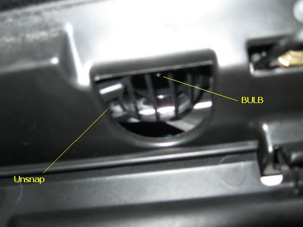

Mine has glove box light. It fits Sylvania 2721 same as the shifter light. The light is helpful, as my first aid medicines are in the glovebox.
Ok, you can access those bulbs in the hole before the secret compartment. Just feel it with your finger and unsnap the lock.:)

Well mine has not worked ever since I bought my 4runner new and yours doe not appear to work either. Gonna ask the dealer about this one. Maybe there's a hidden one in the concel too I have not found.
Since I bought my 4runner used, and its a 2003, that light was not working also. I replaced it last 2007 when I knew that there is a bulb there. I use Sylvania 2721.

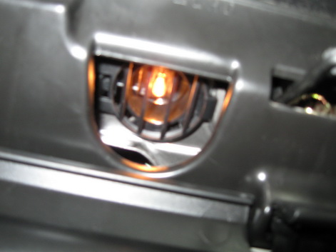

The ACC should be turned ON, and when you open the glove box it should auto illuminate and off when closed.

I just checked mine, 2003 Limited. Light does not go on with the ACC, the lights have to be on. Nothing in the glove box.
I too went and checked mine. It does comer on with the headlights. Guess I aways go to the glove box while parked to look for something. Headlights off of course. Leave it to the Japanease to make it that way. Our way is much better using a switch that makes the light come on when needed instead of all the time when the headlights are on whether the glove box is opened or not. Now if only they had put one in the console.
