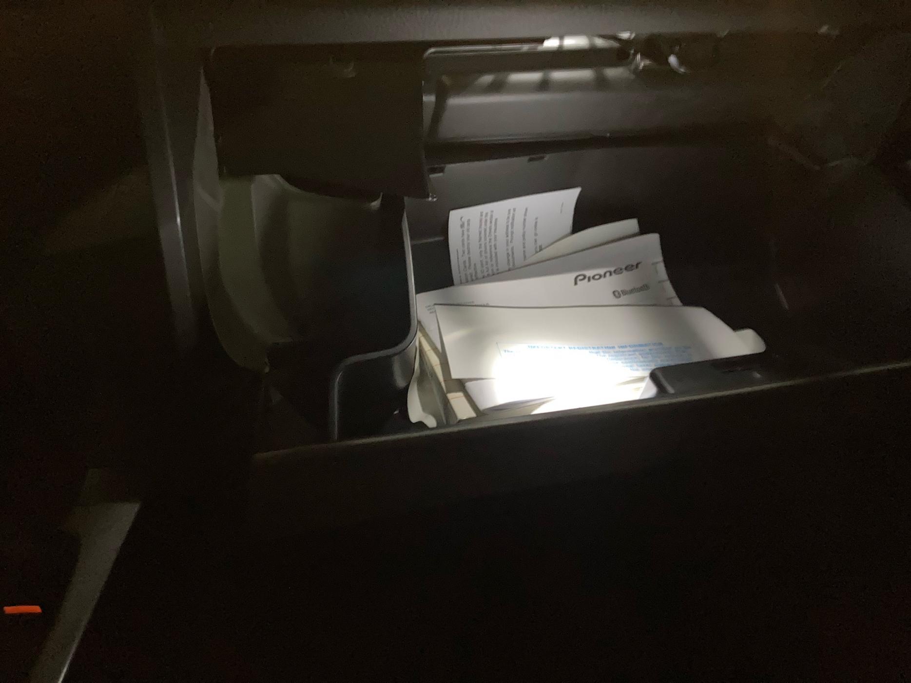

I just replaced my burnt out bulb with an LED. Here's a link to the one I used and it works perfectly. Small and bright.
https://smile.amazon.com/gp/product/B07PPLY8FF/ref=ppx_yo_dt_b_asin_title_o01_s00?ie=UTF8&psc=1
