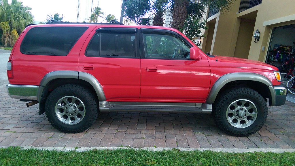

Ok, I had to decode the VIN, and I actually have an SR5, that has apparently had the Limited exterior trim added to it. According to the charts this was never even a color option at all. I guess that explains why I've only ever seen one other one with this color combo.
I feel much better now. I was starting to worry that I had some sort of swapped Frankenstein monster in the driveway. :gun4:
