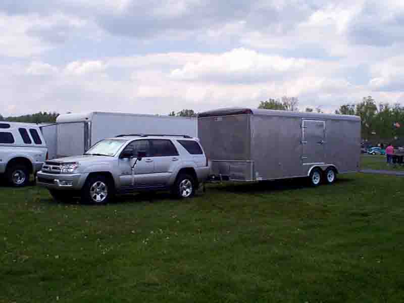

Car Trailer:
20ft long x 8.5ft. wide, 3,200 lbs empty, ~5,400 lbs loaded, weight distributing hitch with sway control.
MPG when towing ranges from a low of 7.26 (mountains) to ~10.
I use additional towing mirrors because the stock 4Runner mirrors have TOO many blind spots.
