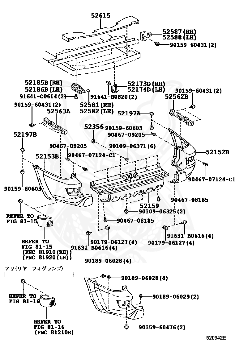

I have been looking an here for quite some time and love all of the great information and write ups everyone takes the time to post, so thank you all! I found these from the gen4 hilux. Not sure if they were on here, but I couldn't find info on the rear fog lamp hilux mod.
https://www.ebay.com/p/654594334 is the stock rear fog switch
