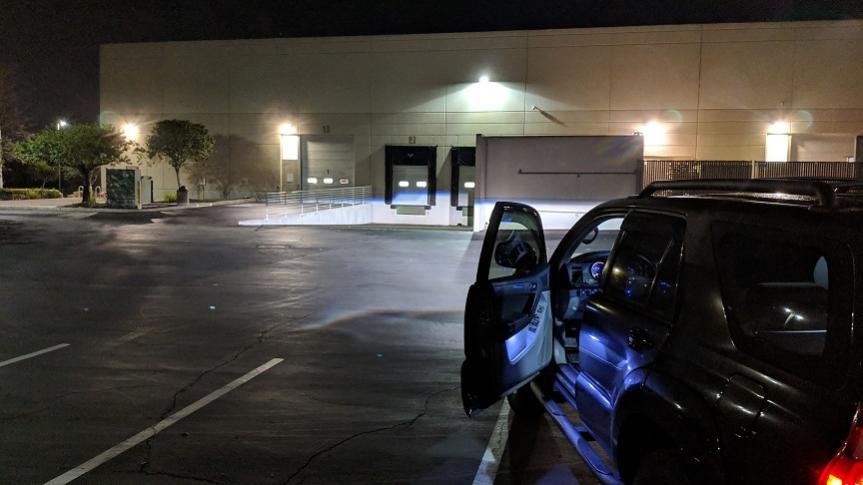

I finished the 03-06 projector install a few weeks ago and have been battling an issue with the passenger side performance. I can't get a nice hotspot. The hotspot is pretty funky. The driver side is fine.
I'm pretty sure this is not how the hotspot is suppose to be, right?
This is from the first headlight but the second one is pretty much the same.
I am running HIDs and switched bulbs between the driver and passenger and still the same . I swapped out the passenger side headlight with another one and same thing. I doubt I have two faulty headlights housings....?
I haven't done the squirrel finder mod yet on the passenger side but that shouldn't affect the hotspot yeh?
I am getting a 9006-H11 adapter so I can try a halogen bulb.

Agree. It ain't a balla setup but still doesn't explain the weird hot spot. Should still work. :T

ah yeh i was just thinking that! I was going to check on the return wire today. The picture was of the 4R close up to the garage to just get an idea of light output between the driver and pass side. I went on an aiming session run the other week and followed the manual and thats where i discovered the output differences.

the more i look at the main pic, it possible that the projector is shinning through the dot of the headlight lens, usually they use them alignment box thingy.

yeh i see those little dots. I don't think its that. You can see that the way the light refracts off the lens that it's not very "full".
You can see the diff. Not sure what to do. Even the halogens (Osram Night Breakers) do the same thing. I'll prob try another pass side headlight.

could also be burned bowls.

Dim projector?
I had the same “shadow” with my passenger side as well after installing the HIDs. Also had the green hue. I took my phone camera and checked into the headlight with it and found that there is a welded looking spot on the inside of the lens shield on the right of the ‘squirrel finder’. I took a closer look and it looks burnt through. The green hue is coming from the reflection of the burnt aluminum shield and the circular shadow is coming from the burnt hole in my shield. Here are some pictures so you can take a closer look. ….. iPhone photo won’t upload. Later I’ll try again. So check the inside of your headlight and see if there are any imperfections. I believe that’s the problem.
