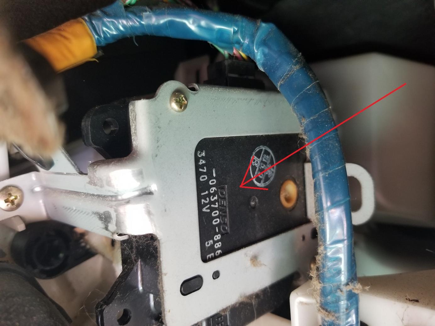

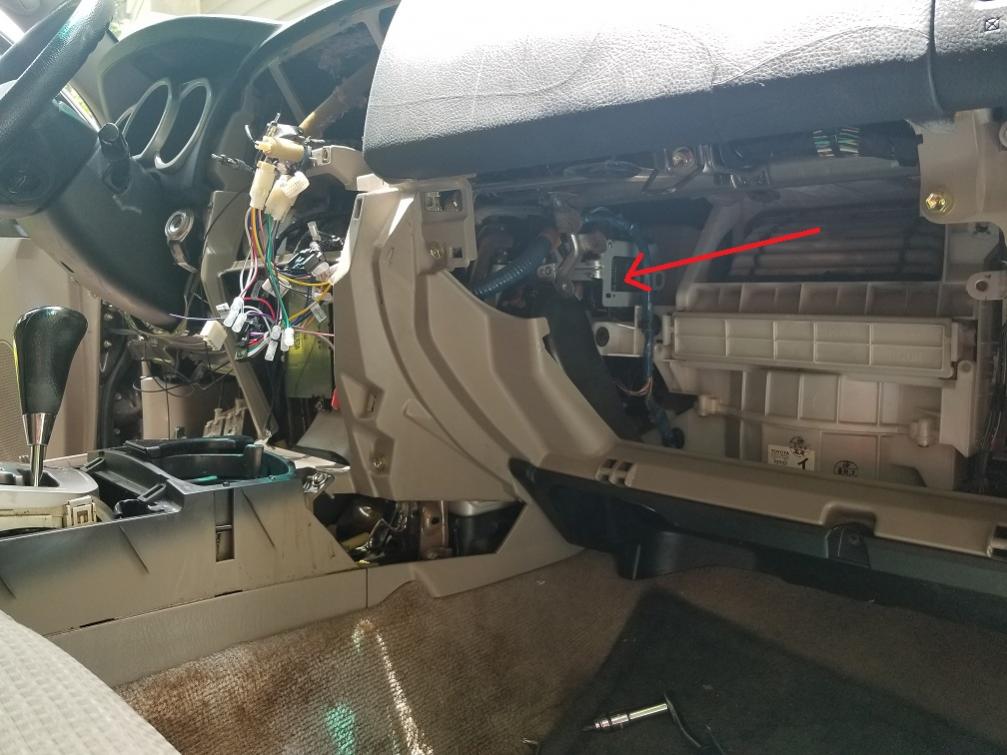

There are a lot of questions about this issue. My 2003 SR5 has the same issue: when you turn the key to ignition, you get a buzzing noise from the right side of the dash that lasts maybe 20 seconds or so, then stops.
It's the AC Damper Motor. If you unplug the connector on top, it won't make the noise. It's a relatively cheap part, but a pain to get to. There are three screws holding it in, and one is pretty much impossible to remove without also removing the entire blower/filter assembly.
Getting to it is easy, just remove the panel above the glove box and then the glove box itself. There's also a Youtube video that shows where it is, but not how to remove it.
https://www.youtube.com/watch?v=kKOhDF-zG6A
0637008860 Toyota 4Runner AC Damper Motor ,
