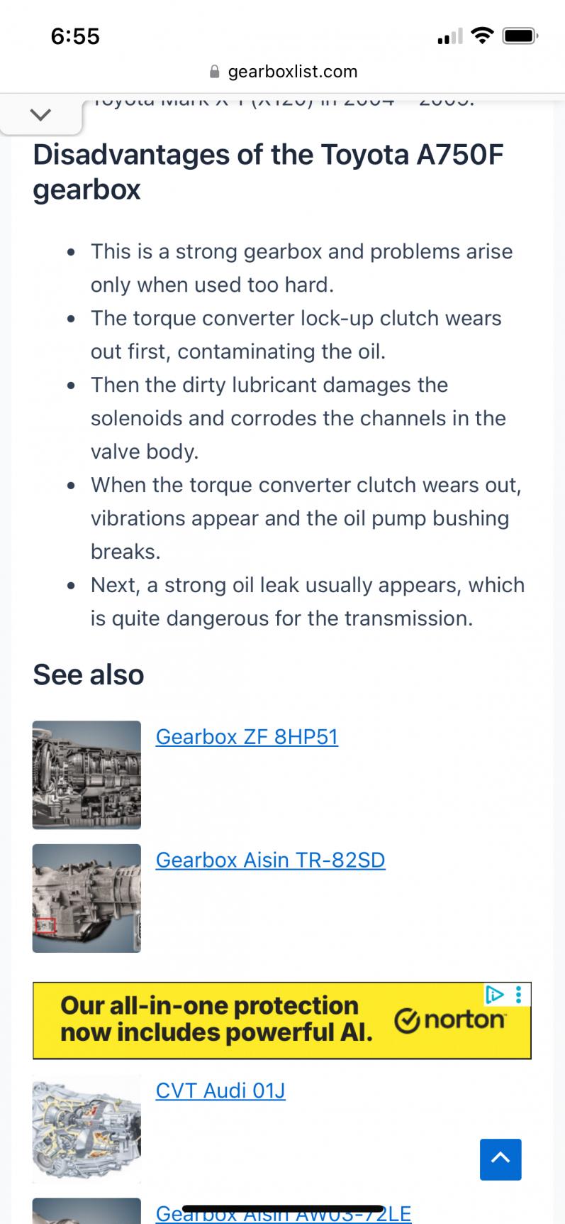

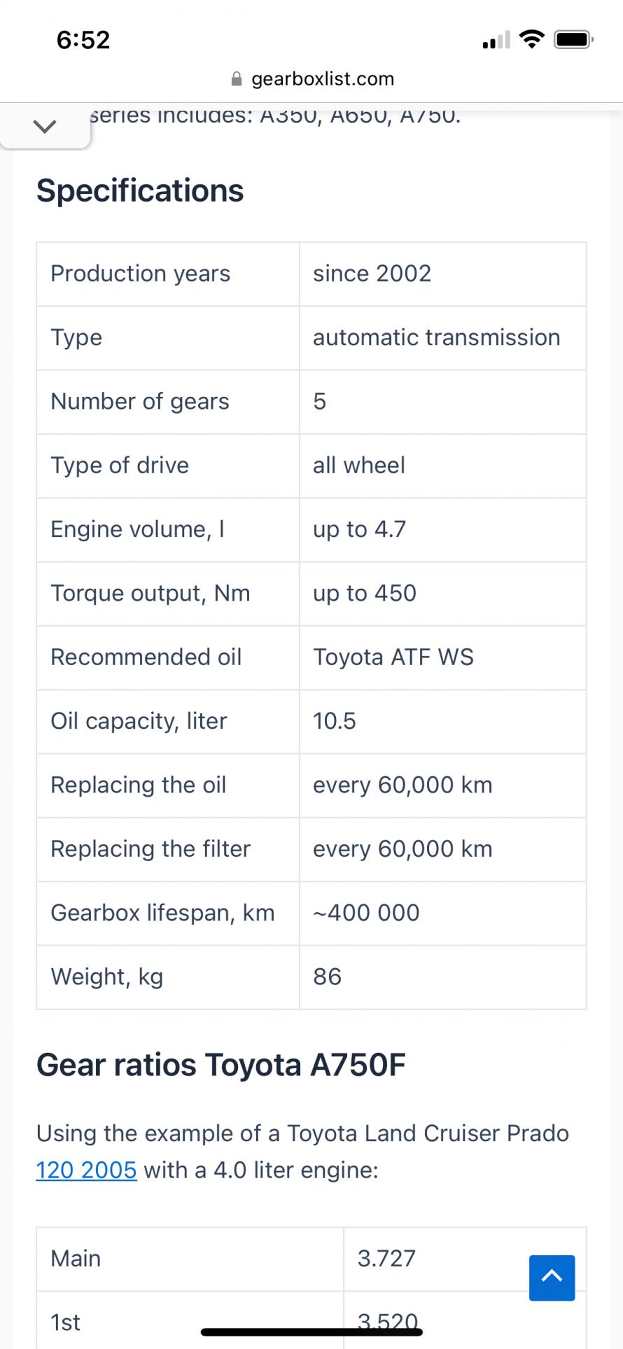

Hard to imagine that the 4.7L is maxed out HP/torque at 75 MPH. That would be easy to check; will it accelerate past 75MPH and keep on going? I think it will.
Perhaps the tranny is showing its age, wear& tear.

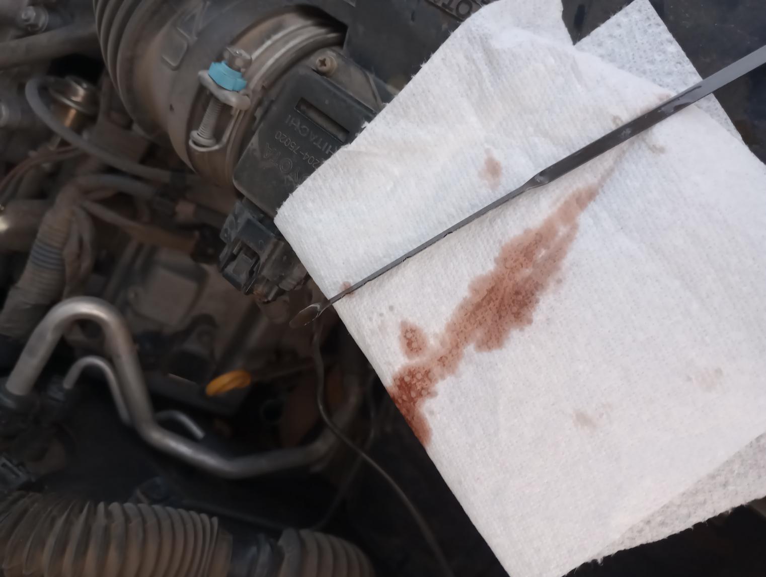

Howdy. 4Runner is doing good, the transmission fluid drain and fill seems to have made an improvement. The RPMs are still inconsistent at times so that hasn't been resolved. I'm monitoring the trans temp too, hasn't gone over 163°f
