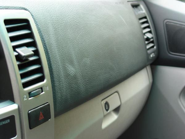

Oh boy. I've been noticing the dark grey dash on our '03 SR-5 has accumulated a number of light grey dirt streaks, so today I swiped it vigorously with a cotton cloth dampened with Windex. Surprise! It looks like the light grey dirt streaks are actually places where Windex has in the past removed the grey coloring from the dash in a couple of places. Now, there are some very large, prominent light grey areas that appear to be from the Windex I used today removing the color. Just to be sure, I tried cleaning with another mild household cleaner, which seemed to aggravate the discolored steaking.
This can't be happening, can it? Tell me the 4Runner dash material isn't so delicate I've ruined it by using Windex on it...

I'm worrying now that the problem I have with dash streaking is worse than I thought. It doesn't appear the Windex just removed the color so much as it destroyed the surface material itself. The day after I caused the streaking with Windex, I rubbed the dash with a DRY white terry cloth. This caused another streak, and looking closely at the streaks it appears the surface is abraded and rough, not just discolored.
I did try the official Toyota vinyl treatment - the parts department person thought it would take out the streaks. Well, it didn't, although I think it is a bit better. The vinyl treatment did not leave the oily Armor All look, but it did darken the color of the dash material. But hey, that's the whole idea :)
Attached (I hope) is a photo of the streaked dash *after* the treatment with Toyota vinyl protectant.

The manual says you can't use window cleaner on vinyl interior.
In the owner's manual, page 305 says that window cleaner cannot be used on the vinyl interior. Solvents, gasoline, thinner, etc. cannot be used on the vinyl interior either.
It has to be the ammonia in the Windex that's causing the discoloration.
If you want to be safe, you can spray Windex on the towel and then clean the windshield.
But I would go for non-ammoniated window cleaner, like Armor All Auto Glass Cleaner (which has no ammonia in it). I used it on my 4Runner's inside glass, and when it leaves spots on the dash, I clean it up, and no discoloration.
Let Toyota know that this is not acceptable.
This discoloration is rediculus. Now what am I to do if I take the car to full service car wash. Tell the guy to cover the whole dash when he cleans the front winshield? We should complaint to Toyota about this. The dash is right under a huge "glass" winshield. No matter how careful one is, there is going to be some windex/glass cleaner falling on top of the dash. Gasoline and solvent is one thing but Windex?

c44me, I really feel badly for you. That picture looks horrible :(
I guess this "rugged" vehicle doesn't have a rugged interior. I hope it can at least handle dust and some UV rays.
It would be one thing if all interiors were like this. But they're not. One of my vehicles is 17 years old. It's had plenty of overspray from Windex and guess what? NO streaking, NO discoloration.
