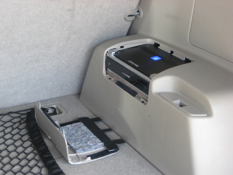

FYI - the Alpine PDX will NOT fit in the stock AMP location. It's just a wee bit too big, even if you cut/trim the location. However, the installer did a great job of hiding the amp in one of the mini cargo carriers.
Lastly - they used the stock sub box for the new Kicker...but they put in polypropelene (pillow stuffing) to make it "more dense" before sealing the box up. I'm guessing that helped.
Anyways, here's a few pics of the AMP location.

So what are you using to power the Kicker 8" sub? Isn't that alpine amp 1000x1. Isn't that to much power for that sub?
It's the Alpine PDX 5.1 (4 x 75w + 1 x 300w). That single Alpine powers the whole setup and it screams - I can't crank the vol all the way for fear of shattering something (window, ear drums, etc)
