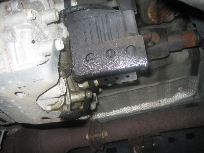

Hi everyone, I believe I may have the same problem. I am pretty mechanically inclined but since issues with the transfer case aren't every day regular maintenance problems I'm not completely familiar with it. I assume the black housing with the electrical connection mounted on the vehicle rear side of the transfer case is the actuator you guys are referring to? If so, mine appears to be leaking between the linkage point where it is mounted as well.
I maintain my vehicles meticulously and have never had a problem with my 4Runner since I've had it. It's an '04 V8 4WD (full-time) with 115k miles. I just bought a new Tundra and have only driven the 4Runner 2-3 times since the first week of December. When I backed it out today I noticed a few drops of fluid on the garage floor and crawled underneath to inspect. I am absolutely certain this is new since I have a habit of checking the garage floor regularly for fluids after owning two jeeps. :D
I attached pics, can you guys confirm and if this is indeed my problem offer any advice on repair?? I'm handy with the wrenches and not afraid to go after it myself if I'm reasonably certain it can be done without special tools or procedures that require the 'experts'. For what it's worth as well, the ole gal is up for sale after I get this repair finished if anyone is interested and is near South Carolina. I hate to part but the wife won't allow two trucks in the driveway, and probably rightly so. Other than this issue she is in fantastic shape, if you have any interest just reply or send a message and I can send plenty more info.
Thanks in advance for your help!!

Hey tat,
Looks to me like a perfect example of the famous leaky actuator. Sorry. Looks like the leak is right where the shaft goes into the transfer case (hidden in the photo) and running down from there.
