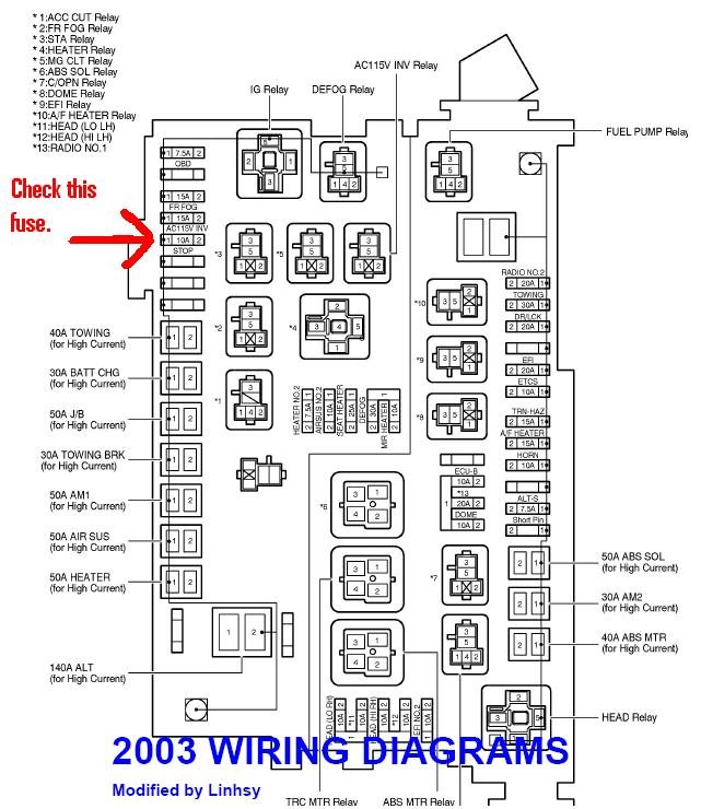

check this fuse

there is no aftermarket or extensions for it.. it doesnt need to be extended... the force or the upper control arm flying up might have torn/pulled or over stretched something.. when i did my lift, it happened to my pass. side because i forgot the leave the castle nut on.. and i got the same lights.. i got a new one from the dealer and it was all good!!
good luck
btw, no fuse was blown when it happened to me.. i used a scan tool to pull the codes and this was what i got.... i'm also running Cornfed 3/2 spacer lift
i only said check the fuse b/c my high mount brake light shorted out and blew that fuse and all those lights came on...i was goin crazy for about 20 min trying to figure out what the hell happend...then my gf mentions to me that my brake lights are out. i come find out that the fuse blew and replaced it and it blows again...pull all the lamps out put in one by one find that one defective. now it works. jst something to check first...simple 30 sec thing that could go wrong.
