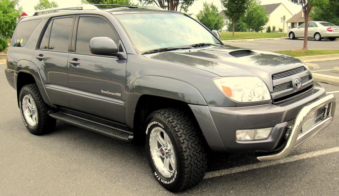

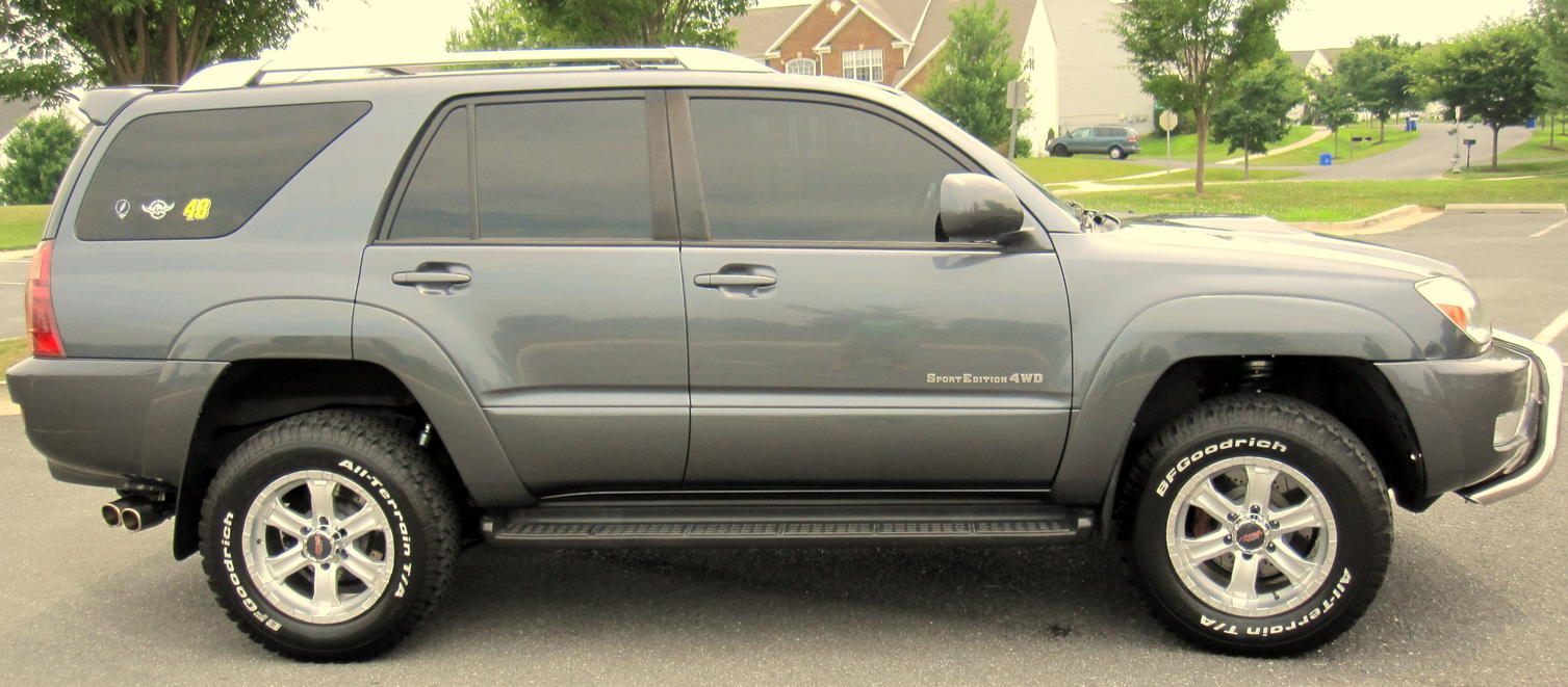

I put a 3" Toytec Ultimate lift, Rims, Grill inserts, Bull Bar and the BFG's on my 2004 V8 to give it a beefier-unique look. Running a K&N CAI and Magnaflow Cat-Back with PNP UniChip. Sweeeet set up !!
