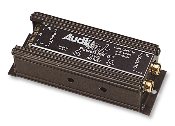

This is the only one that I have ever used. It is made by audiolink. They are probably all about the same, but this one seems like better quality compared to others I've seen. You can usually get places to throw them in for free when ordering other stuff. Sound quality may suffer compared to a fully aftermarket system, as you said, but will be so much better than now that you probably will not care.
