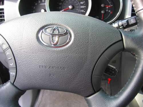

All I know is that on my steering wheel, the cruise control is a lever on the right hand side of the wheel. The buttons on the left are for radio controls, and the buttons on the right are for voice nav and bluetooth. Since I don't have the nav system, I just have blanks where those buttons would go. See the pic below. I pointed out the cruise control with a red arrow.
