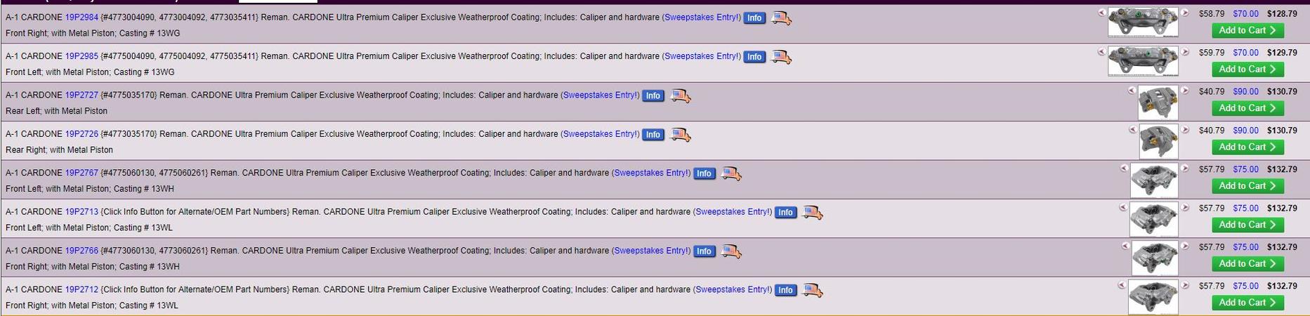

Look at the remans on Rockauto, specifically the A-Cardone.
Has a "Weatherproofing Coating" and I can't complain. Been having them almost a year with no complaints.
Decent priced also.
