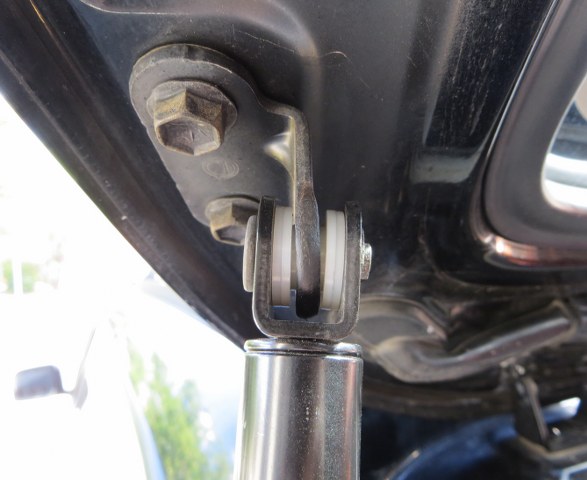

I have the strongarm's on mine, and they are great. Pick up some nylon spacers and washers from Ace to make your own bushing. I had a buddy cut down the spacers on his lathe (1/2" long I believe), but it can be done by hand. There is a thread or two around here that talks about this.
Pic is quite helpful. Got an Ace around the corner.

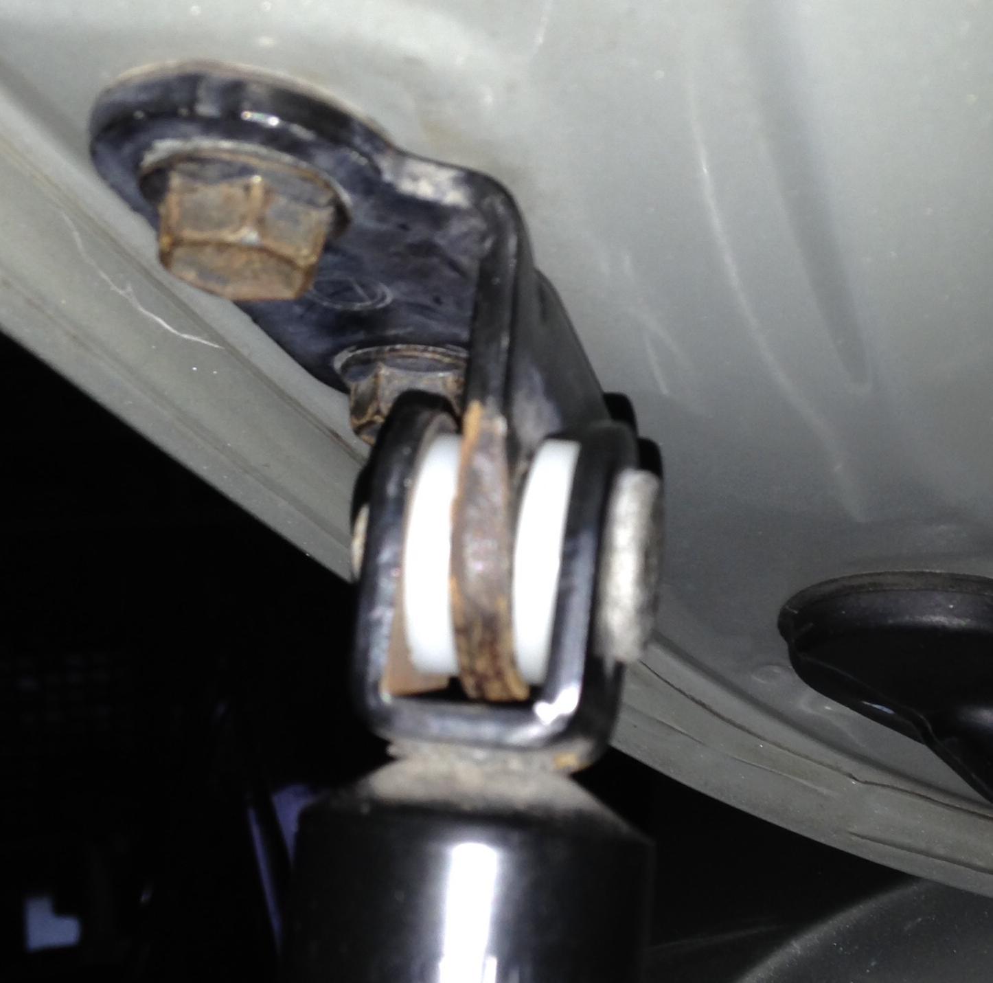

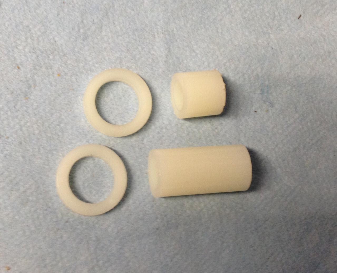

Ace hardware didn't have the bushings I needed. Their selection had been hopelessly mixed and pilfered. I went to Lowe's and found what I needed. I cut the 1" length inner bushing down to ~11.5mm length with a hacksaw. It's a decent fit. The side washers I left as is, using one on each side. Here's some pics showing the parts bags, inner bushing before and after cutting, then installed.
Thanks for the suggestions!

Winner winner!
...Ace hardware didn't have the bushings I needed. Their selection had been hopelessly mixed and pilfered. I went to Lowe's and found what I needed. I cut the 1" length inner bushing down to ~11.5mm length with a hacksaw. It's a decent fit. The side washers I left as is, using one on each side. Here's some pics showing the parts bags, inner bushing before and after cutting, then installed.
This was EXACTLY the thread I needed at the right time!:thumb: The top openings mic'd out to 0.470 and I used a tiny pipe cutter to score the bushing to ~0.472 straight. I then used a sanding block to trim it down. Looks way better than this pic shows (after all, it is zoomed in). Definitely would have preferred black nylon, but didn't realize there were even any bushings/problems (mine were beyond destroyed) until we (wifey joined me) were committed:confused:! Got the struts from RockAuto:
MONROE 901446 Lift Support $ 13.33ea *2 + shipping $33.55...ain't no way I am paying OEM prices for this and ~$2.50 for washers/bushings.
