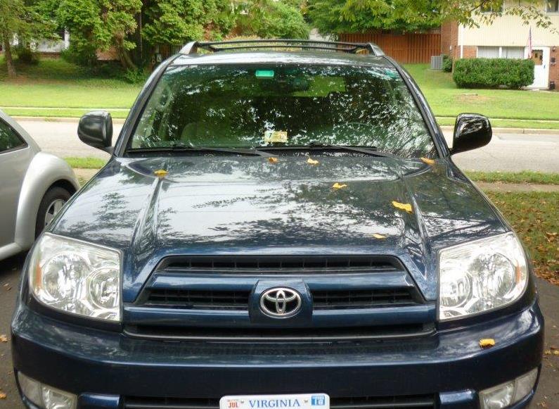

One thing I didn't look too hard for was a color matched mirror. I only planned on replacing the one side so I went with the 'black' heated mirror Toyota part number 87940-35630-C0. I got it from partznet (Conicelli for $233.84). The problem with this plan is that the black is not the dull black of the SR5 mirrors but rather the high gloss black of a black 4Runner. I'll either replace the other side or just spray paint it high gloss black so it looks the same. Probably the latter right now.

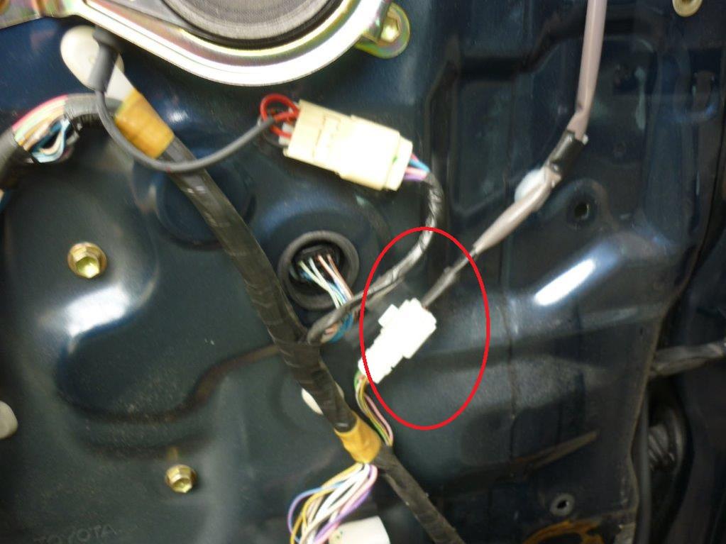

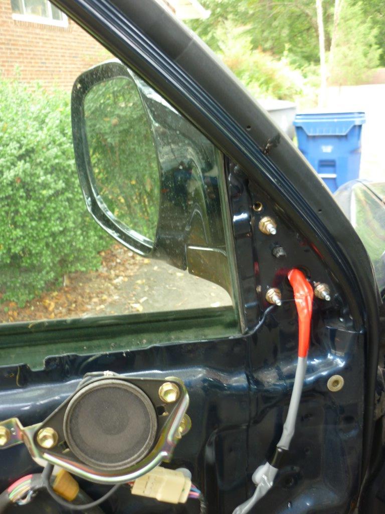

This is a 20 minute project. The 4Runner is pre-wired for heated side view mirrors. Just pull the door panel off, remove the three 10mm nuts, unplug the old mirror, swap and reassemble.
I took some pictures just because you have to have pictures but probably not really needed. This is super easy.

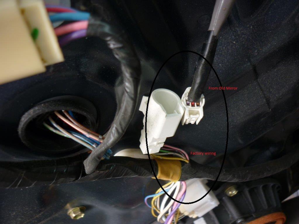

Photo 2 shows the connectors unplugged. Note all the extra wires on the factory side. That's the heat and yes, I have a heated mirror now :)

Put a couple of good coatings of wax on the passenger side mirror and buff it with a microfiber cloth between coats. My SR5 mirrors are glossy black when I do this. This works for the roof rack as well.
Thanks for the tip. I'll try it out.
