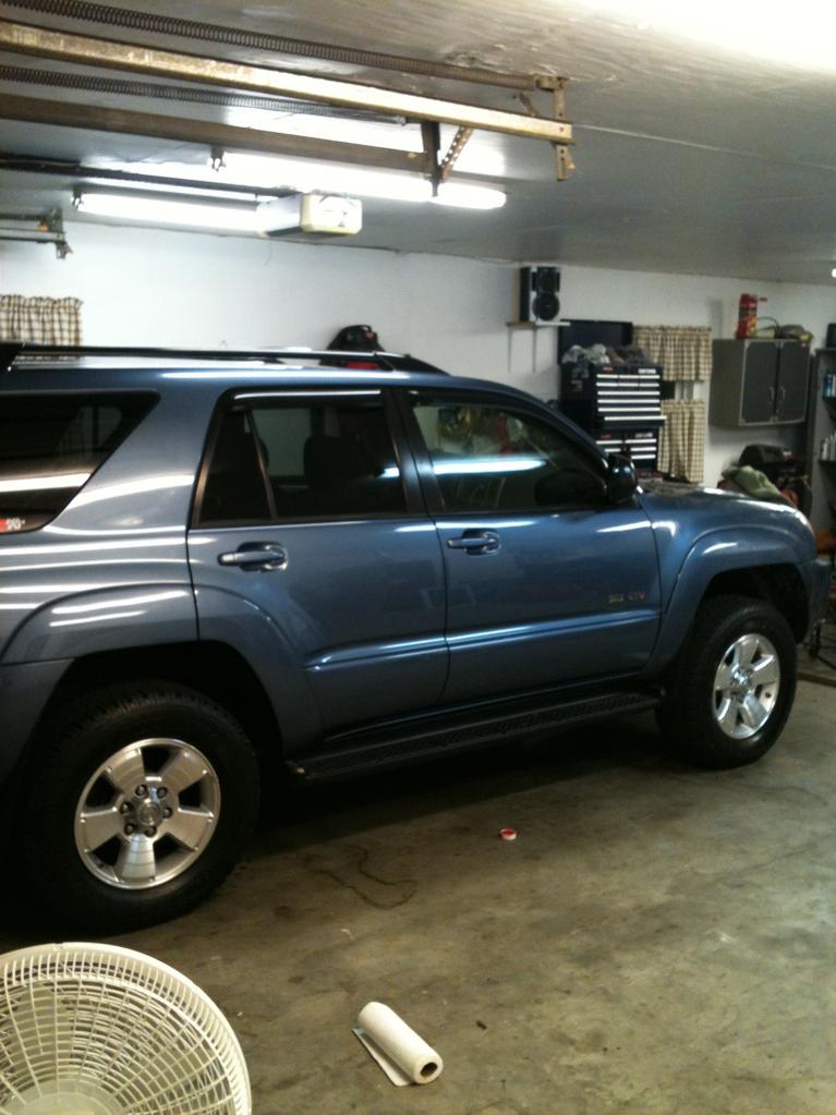

Just installed 2.5" daystar budget boost strut spacers in front. Figured this would level out the front with rear to get rid on some really bad rake. Front end now sits 1/2" higher than rear. Doesnt sound bad on paper but looks like I have a bunch of dead bodies in back. My resolution to this problem is to install the "toytec superflex 2" rear coil lift". Does anybody see any issues using these 2 components together? Would I be better off just getting the 1.5" rear daystar spacers? I eventually want to upgrade all of my shocks and coils, so I figured I would start with my rear coils. I am running 265/65/17 geolander at/s( not my choice of tire, came new with vehicle. Waiting to wear down and get 265/70 destinations.) Any input or comments on this would be greatly appreciated as I have already bought the coils but they havent shipped yet. Thanks!
2004 sr5 4.7L 4wd
This is how it currently sits

I know but the search bar isnt being too friendly on this subject. I read one thread that said it is not the best idea to replace springs unless your going to do the front and back. Basically my question is do you think it will ride ok with upgraded lift springs in rear with stock rear shocks, and stock front struts with a spacer kit?

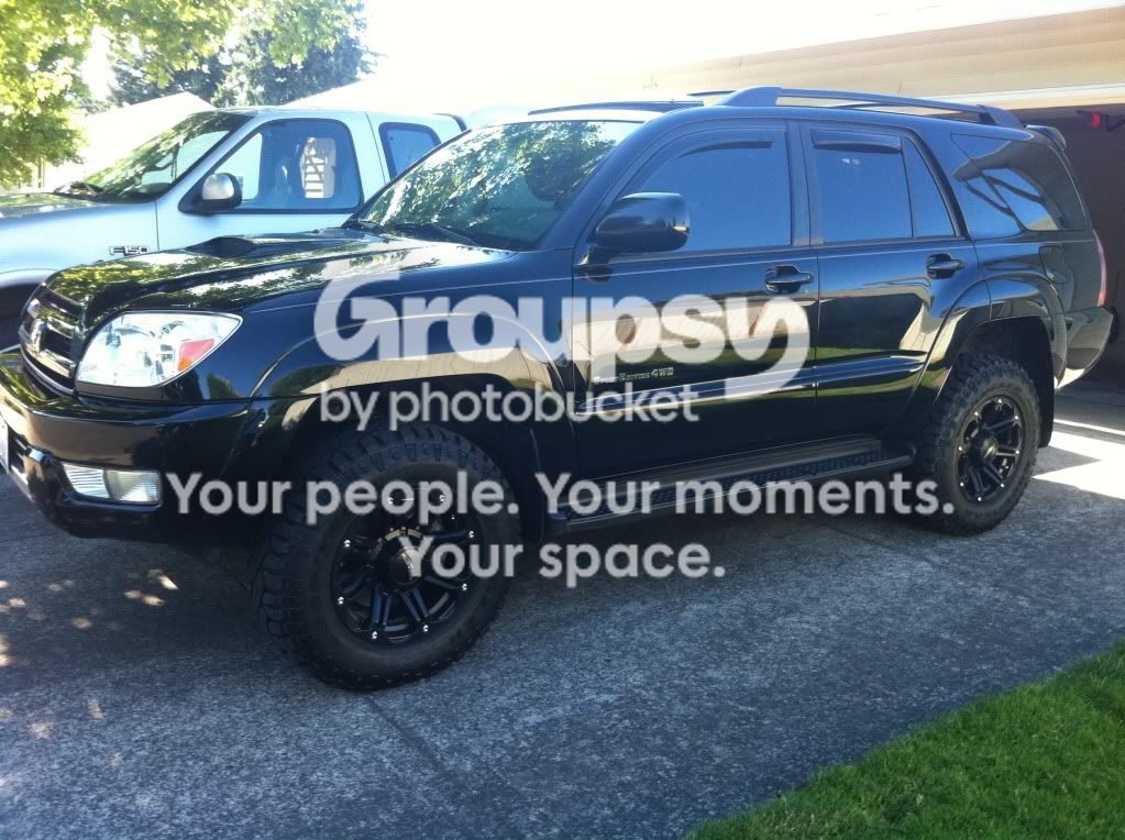

Just get the DS 1.5 rear spacer it will give you the look you want. The 2.5 and 1.5 come as a kit from DS to level out our trucks they are meant for each other:) I installed the DS kit and I'm very happy with the results I'm also running the 265/70 tires. Heres what my truck looks like with the kit installed.

While you can definitely do the rear coils and I hear good things about those, I think it defeats the purpose. You will end up with almost the exact amount of rake you started with. To actually level the 4runner id probably do the spacer and wait on the coils till you do the full swap.
Yea I cancelled the order for the springs. Ordering the daystar 1.5" rear lift. Thanks guys. Will post pics in the lift thread when finished
