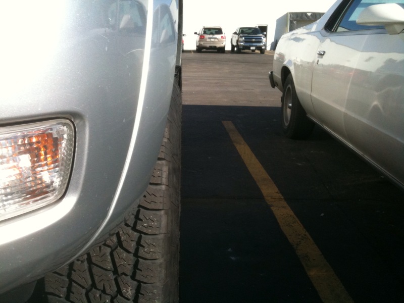

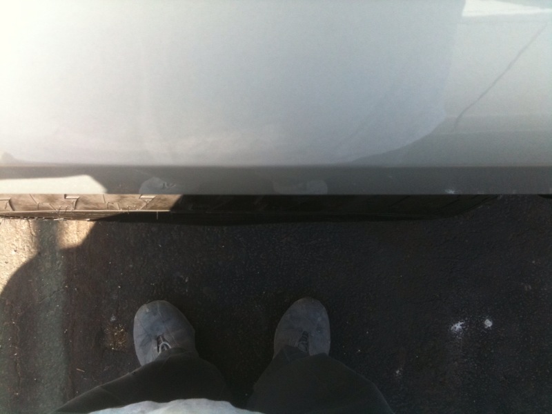

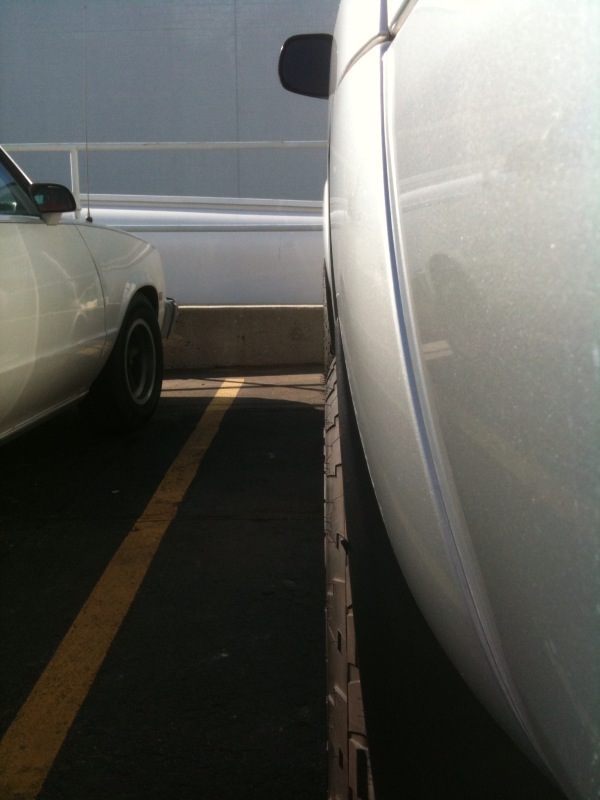

OME 884, 895 w/ toytec top plate, pro comp 17x8" with 4.5" backspace, 265/70 nitto terra grapplers. I got a few PM`s for pics of how far the wheels stick out. So here they are!

The were rubbing on the inside of the front mud flaps at full lock. A little trimming and its all better! Those other shoes are my work ones and are covered in auto paint!:biggrin2:
The new wheels look good! Just enough offset to stick out a little and give a wider stance.I have been looking at these wheels for a little while and went back and forth about the size 17X8 or 17X9. The 17X8 look just right! Good work on the lift and the wheels.
