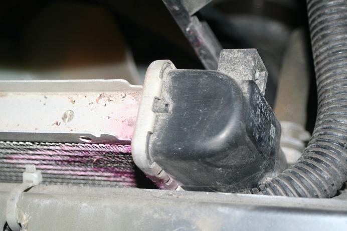

Found time to take a closer look. Pulled the top trim cover off (pop out 11 clips) and it was immediately evident that:
... time for a new radiator...

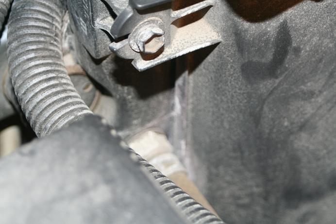

Here's a (not so clear) before pic where I thought there was a small leak at the crimped joint near the top of the tank because of some pink coolant residue.
(Edit: Turns out it's not the seal or crimping.)

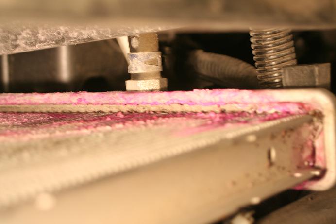

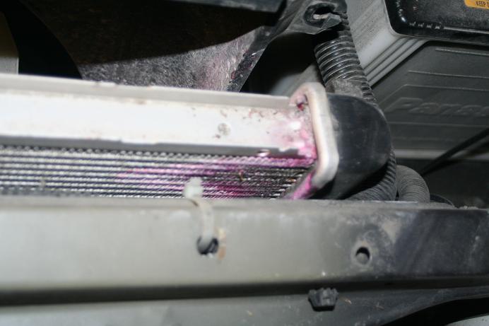

Here's the bigger issue at the top corner of the core.
New OEM rad from the stealer is C$927 + tax = 1047!
I've got an aftermarket on order for C$297 (includes tax.)

Sheesh!
Gotta love it when they use cheap parts on a 25k-30k+ vehicle. It would have been nice if they had spent a few extra dollars and got an all metal radiator.
Well, now the mystery has been solved...I have a sudden craving for pink lemonade...
