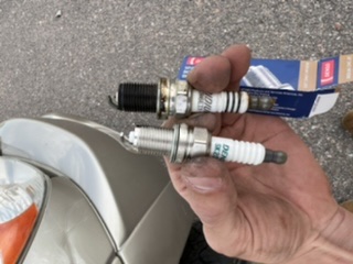

I’m a fair beginner when it comes to working on engines but after buying my used 04 4runner it started hard misfiring and throwing codes. Due to bad spark plugs it was an easy fix. After a few months it started stuttering at highway speeds around 3000 rpm. I thought this was due to a fuel pump, clogged fuel lines, fuel rail, or fuel filter. One day the check engine light was blinking during the stuttering then quickly turned back off. I was still able to pull the code and it had a misfire in cyl 4. I swapped the ignition coil with another cylinder and the code followed the cyl so luckily I was able to track it down to one failed ignition coil. Bought a new one replaced and code hasn’t come back. I also had the same p0430 code and replaced the downstream o2 sensor. Code hasn’t come back.
Your issue sounds like a fuel or spark related issue. Sounds a little similar to the problems I had.
