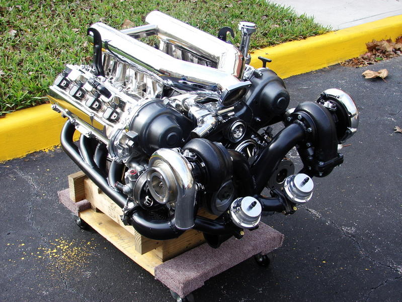

V8 engines and putting them in supras after making them look like this!!! i think theres a company that'll build this set up for you for like 8k so if you got deep pockets have at it lol.
What kind of numbers do those put out?

looks like 750hp on pump gas 1000 on racing fuel..
TTC Performance 1/2/3uzfe twin turbo kit

I guess a turbo would work also! Does anyone make a turbo kit for it besides the $10k twin turbo Supra deal? My problem is I went from a slowish '02 4runner to an unbelieveably slow '10 Wrangler. I had no desire to do any engine mods to either one of those, especially the Jeep, no sense in dumping a ton of money into something to maybe make it adequate. Now that I'm driving something that has a decent amount of power I find myself wanting more!
If the motor is fully built with good parts and with a quality port on the heads. 8K is a steal. I have a 1.6L (turbo) fully built from pan to cover (me doing a good bit of the build) and I have right at 10K in the longblock. 8k to include snails, I/E manifolds, waste gates.. not a bad deal imo.
