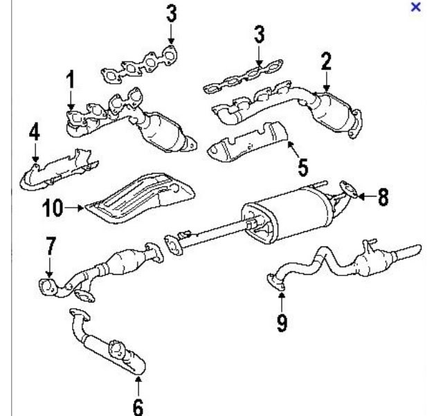

I'm not near my Runner right now but don't we have two of those cats?
Yes. They are integrated with the factory exhaust manifolds.
#1 and #2
