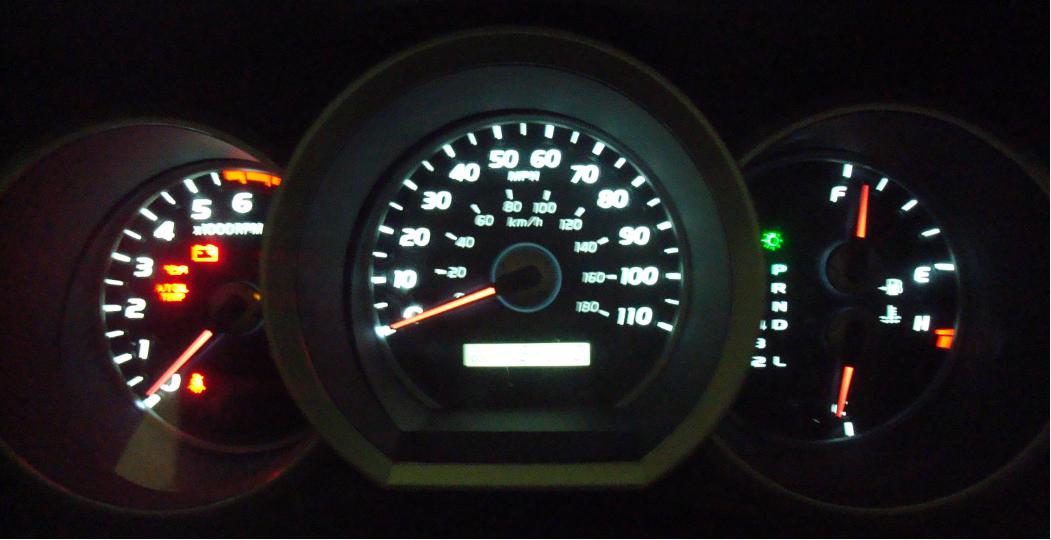

Where on the pic is flickering?
MikesToy~
Hes not referencing any of the lights in your picture.
Hes talking about the display right above the HVAC controls, thats shows the gas mileage, etc.
