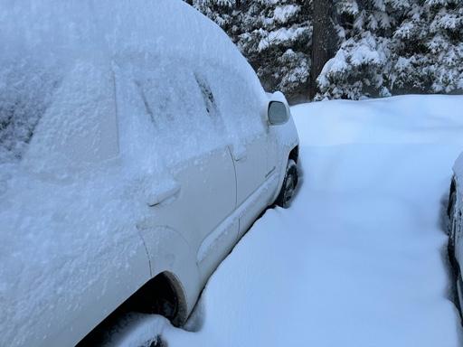

I get into the truck, get it into 4h, then 4l, lock the center diff, and start to drive
You got into 4L. All you did was have lower gearing and let ATRAC be aggressive as possible. In snow, you could've just been in 4H and had the center diff on and gotten through fine. You need wheel spin, and with 4H + center lock, you would've gotten just that.
