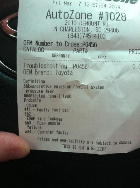

thanks Hokie!! as soon as i read your message i left work and headed to Auto Zone. Here is the read results. Hoping it is the gas cap and not one of the other issues listed!!!

Nice! Gas cap seems to be the common fix for that code. Glad it wasn't something expensive! Let us know if the gas cap def. fixes it.

As for the P0456, its not typically the DTC you'd see for the gas cap, usually that is a P0455. But at this point I'd feel okay with either tightening the gas cap and/or replacing it and checking again. :)
I remember it as a P0441 error that I get about once a year and replacing the cap takes care of it. Just replaced another one two weeks ago and it's eliminated the error again.

I had the same P0456 (VCS lights, VSC TRAC and CEL ON). I didn't need to change the gas cap though. Just tightened it and reset the CEL with a scan meter and its been all good. Guess I didn't tighten it enough after my last fill.
