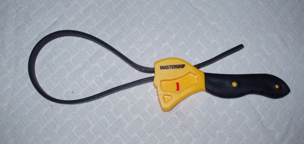

There was another thread on this and they recommended a 74mm (14 fluted) wrench. I just use one of these:

I used strap-wrench pictured above. Bent the hell out of the filter before geting it loose. Just get filter wrench @ Toyota dealer ($6.99).
Ok, just a standard head wrench part?
