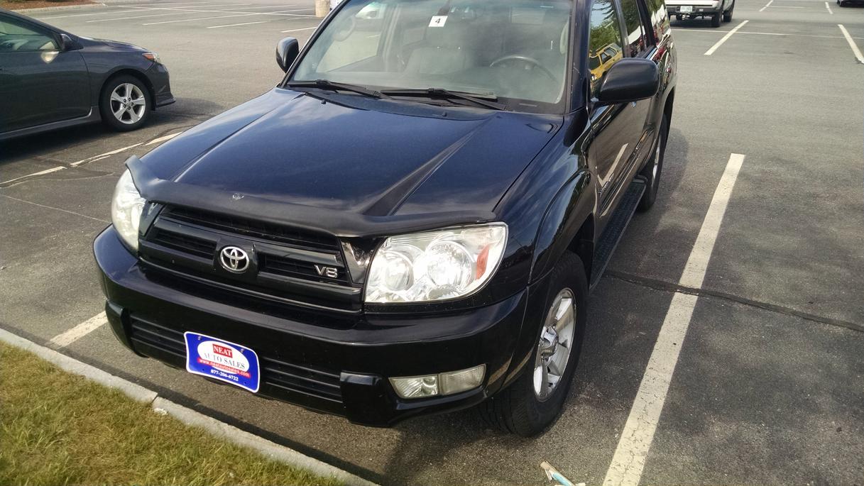

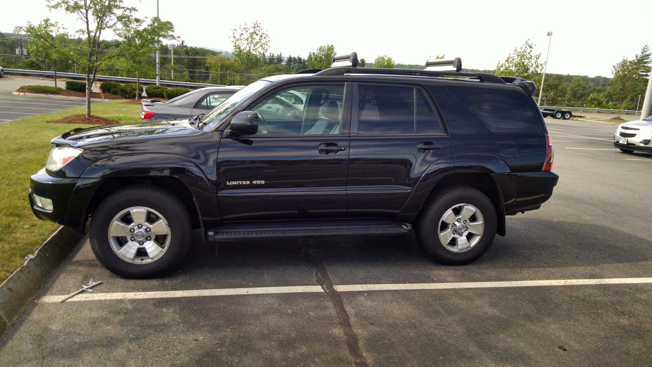

Thanks guys I just joined the forum today I will do some more digging can't wait to get buildin[/ATTACH]g.
