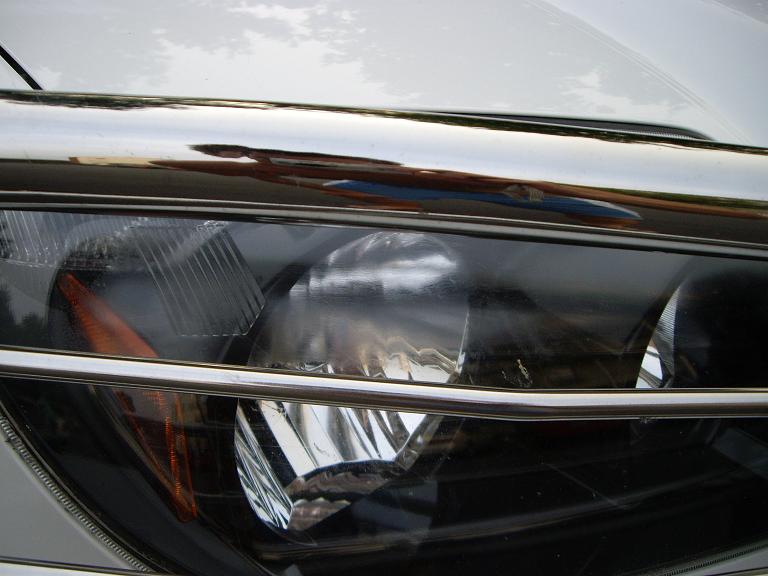

I blacked out my headlights on my 04 this past summer. The orange lense can be removed, but it's a ton of work to get it. You've got to cook the whole headlight in the oven to separate it and then use a screw driver to pop out the orange member you speak of.
I dont know why you'd remove it though, it protects a bulb within the housing.
I hope we're on the same page here?

Yeah I want to remove and replace with a clear one. The older T4R's have a seperate housing that you can just buy a clear version of it. How easy was it to paint the inside of your headlight housing? Would you be able to paint this lense with a tint spray??
Use Krylon Fusion paint, it's designed for maximum adhesion to plastics. With other paint, you're going to have to scuff the housing really good or else risk peeling.
