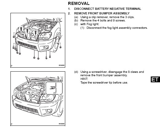

chaz New member May 29, 2008 #1 anybody know how to remove the frt. bumper on an 06?-(6bolts)- im replacing it with a new one thats not scratched & cracked.

mike508 New member May 30, 2008 #2 Attached is a page from the manual for bumper removal. You still have to remove the fog lights etc. Hope this helps. Mike Attachments bumper.jpg 43.5 KB · Views: 177
