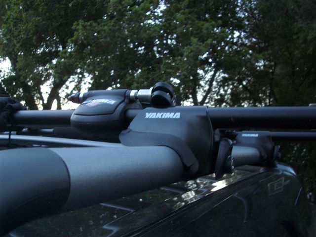

Just got the Yakima LowRider system installed today. It's on there pretty solid!
I had been concerned about excessive wind noise, but surprisingly, it's not all that bad (especially with the moonroof shade closed). There is an occasional low-pitched rumble coming from the roof of the Runner, but once you're past about 50MPH, it becomes indistinguishable from the "natural" wind noise. The fairing, which I also ordered, should take care of this.
Here's a pic of the rack...

Awesome, thanks for the pic! Now we just need to figure out how to remove the factory crossbars! There has got to be a way to pop those plastic covers off like the 03-05MY. But I can't get my to budge.

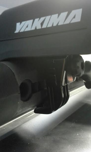

The RailGrab came in, I haven't fully installed it yet, but I can already tell it's going to fit. There are 3 claws included in the kit. The large claw will wrap almost completely around the tube side rail. That claw has a rubber piece on the inside to limit movement, etc. Even the small claw can clip inside the long slit on the inside of the tube rail.

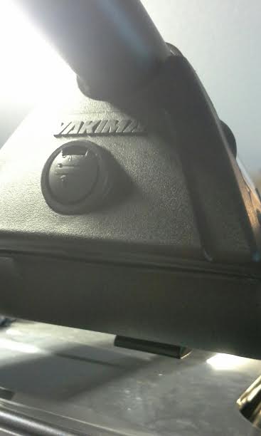

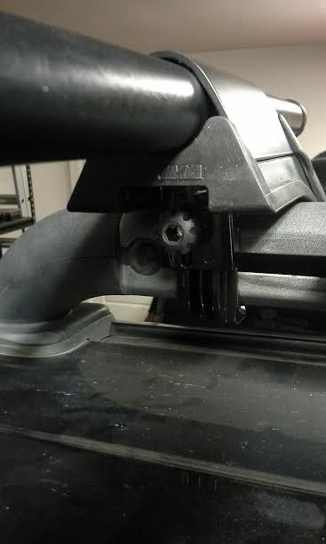

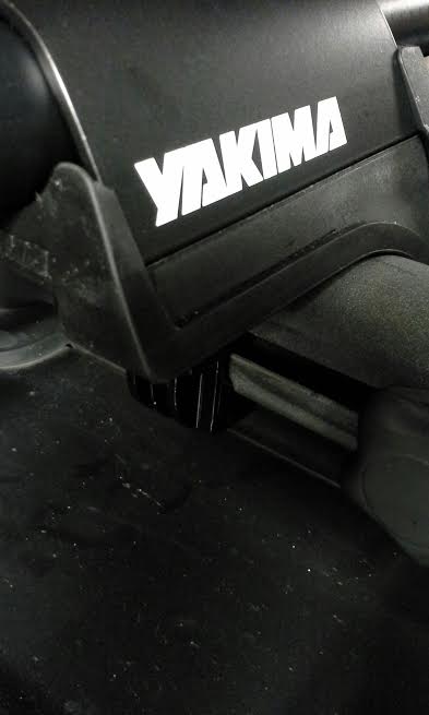

Per the install and pictures below, let it be know to anyone who gives a crap that the Yakima RailGrab does fit an 06-09 4Runner Sport Edition. It's on there solid. I used the largest claw that came with the kit, see pictures below. I used the 58" crossbars (I think 48" would be too short). The correct fairing size is still 38".

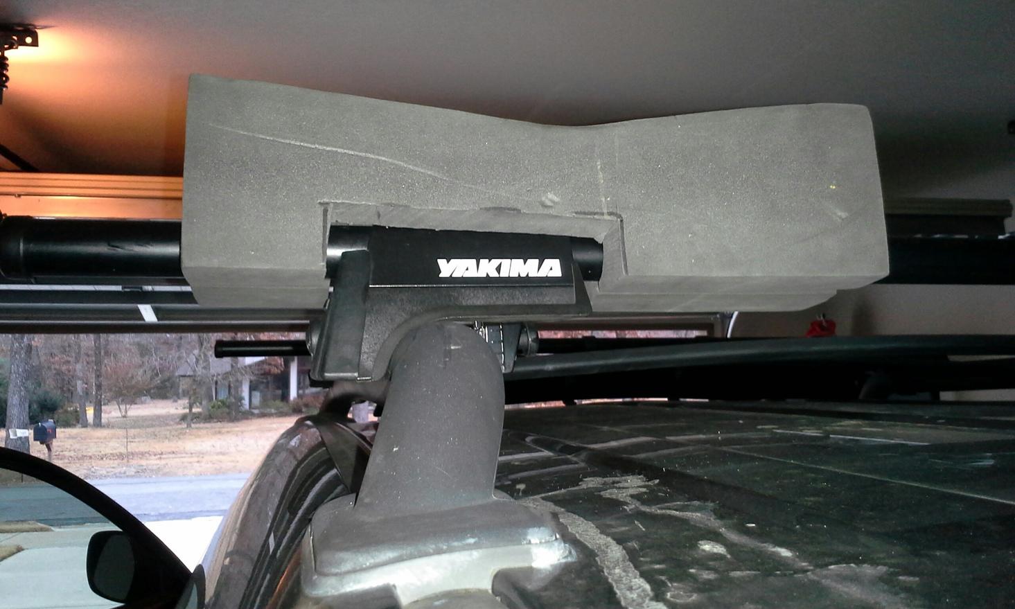

Attaching another picture with foam block cut to fit over Railgrab, for 2 kayaks to be carried side by side, both on foam blocks. Otherwise, 2 diagonal style kayak carriers would be needed to carry 2 kayaks.
