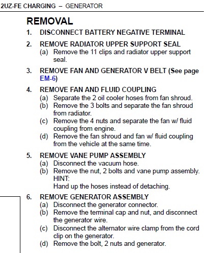

Sorry but you got taken. The alternator in the V6 and V8 can be taken out and re-installed without removing the A/C line and a recharge.
From the manual, V6.

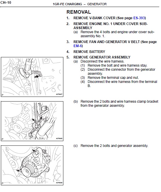

Seymore,
Thought I had grabbed the correct one. Here is the V6, still no A/C removal.
