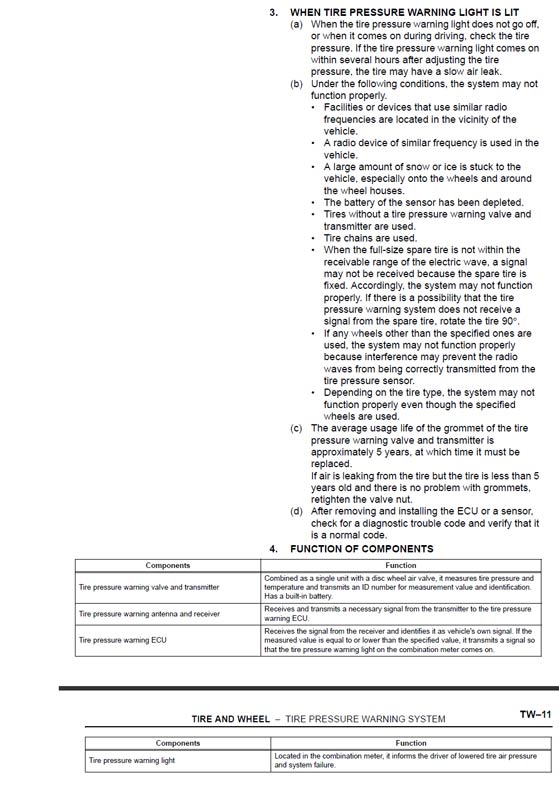

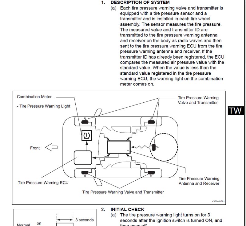

From the Repair Manual:
A direct Tire Pressure Warning System (TPWS) is now standard equipment on all
2004
more sensor notes
Uneek said:
The TPMS isn't that sophiscated on the 4Runner (at least not on my '06).
It isn't any more sophisticated in the '08s either. There's no where in the computer or Nav Sys that I've found that allows a real-time view of the individual tire pressures (like is found in numerous other autos, my wife's '07 Monte Carlo SS for instance).
I read the manual, and they try to scare you to death about dealing with the TPMS deal, but as best I can tell, the vehicle does not know nor report which wheel is at what position. Therefore, I'd think a simple rotation would not require any sort of reset.
I do like that it monitors the spare though. While my wife's car gives a real-time readout of the pressures of her 4 mounted wheels/tires through the computer/DIC, it does not monitor her spare.
