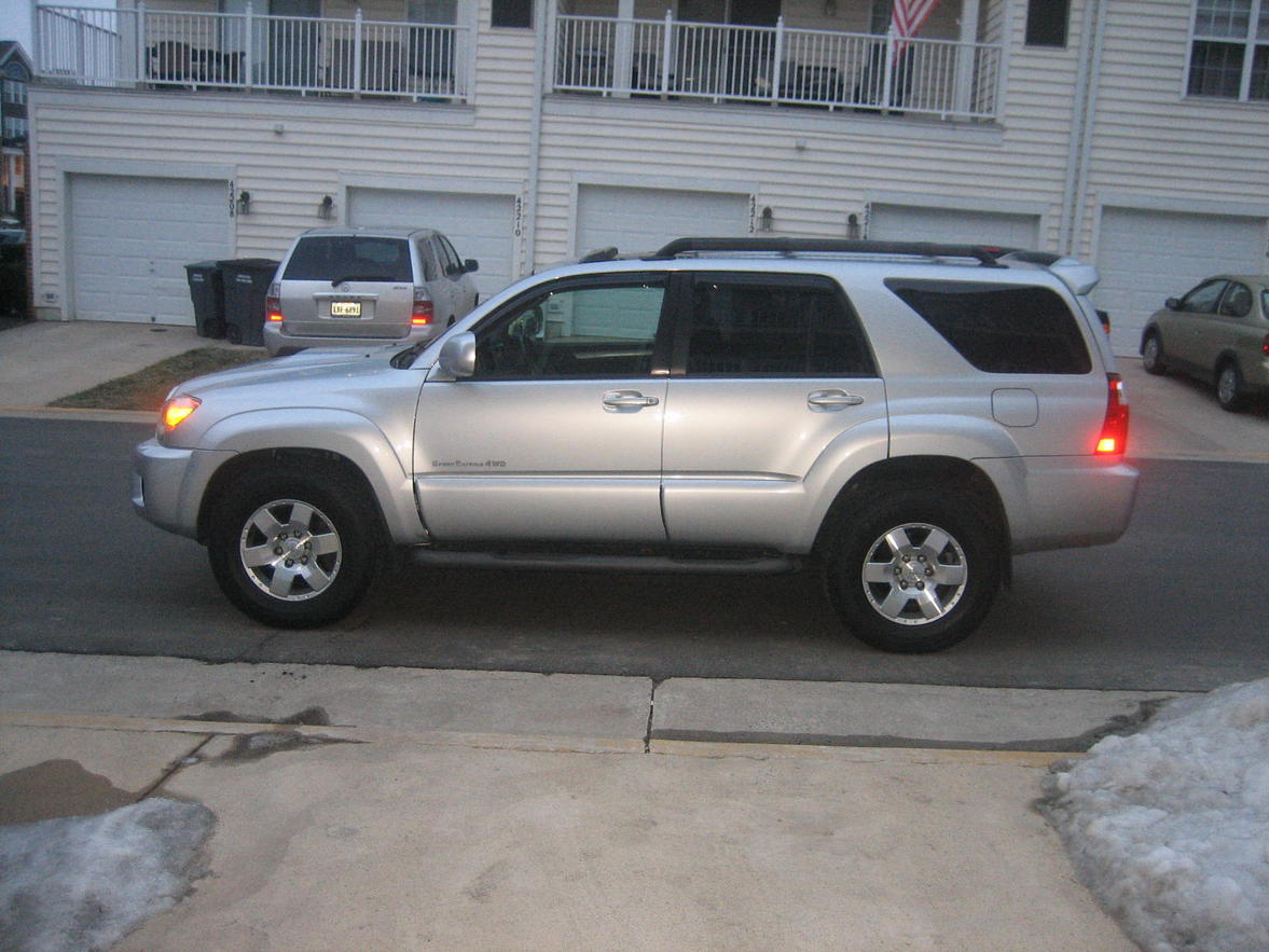

So I found a set of 4 2007 FJ Cruiser aluminum rims and tires. Rims are 17", tires, Dunlop Grandtrek AT20, are stock size - 265/70 R17. They have less than 20k miles on them and are good for another 40k. I can get them for $400.00 and I was thinking of painting them black. I am also thinking about getting the Daystar spacer kit (Front 2 ½" and the rear 1.5" for a level vehicle stance) that is Xreas compatible and Spidertrax wheel spacers for the front and rear...

So I put the FJ Cruiser aluminum rims and tires on the other night. I think it looks good and it doesnt look like I will be getting the Spidertrax wheel spacers. I will post pics up this weekend.
Now I am thinking about going with the Toytec kit or Cornfed instead of the the Daystar spacer kit. I am back and forth on if I should keep the Xreas or not. I have the Platinum bumper to bumper warranty and I am covered to 2014 or 100k so I think Xreas would be covered til then right? If not then maybe I should just pull the Xreas off.
As far as the SE wheels. I would sell them with the tires that are on them. The tires have less then 500 miles on them. PM me with a offer...
