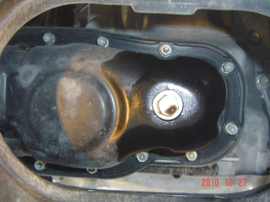

Please Share! What is Toyota 07 V6 4runner oil drain plug’s ft lb torque spec? I know I need to get a manual but this came on me sooner than expected. I saw info of a posted torque that seems high for a pan. I agree it's depending on the design of the pan, type of gasket/crush-washer or not and types of threads in the pan. If it’s not a pipe thread in the pan or crouch washer used, it should be strong enough to take higher torque with standard threads and a solid copper gasket or etc.
Attached is how the lower pan and plug appered after my personal 12/2010 purchase. I snugged the plug lightly to solve this drip and sepage. I'll hope no damage is done to the threads (as I inspect them during an oil change this week). Pulled threads are not easily detected as stripped threads. I'll hope for the best!

The task is over and easier than expected with a little help from the floor jack and stand since I d/n have a lift. My wet oil plug/pan became a concern since this was just two weeks after my purchase. Even though I had lightly snugged the plug and it was clean from then on. My real concern became the condition of the threads in the pan since the 29-30 Ft Lbs of torque on the drain plug was felt excessive by some. It felt fine to me with two torque wrenches (with the crush washer giving/sealing). The threads looked good (documented with Pics) as I do most task for my records and sharing as K.C.’s good pics.
Have Fun Maintaining! Jow
