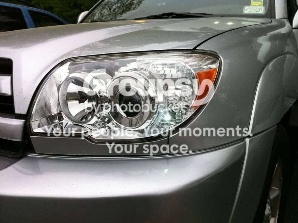

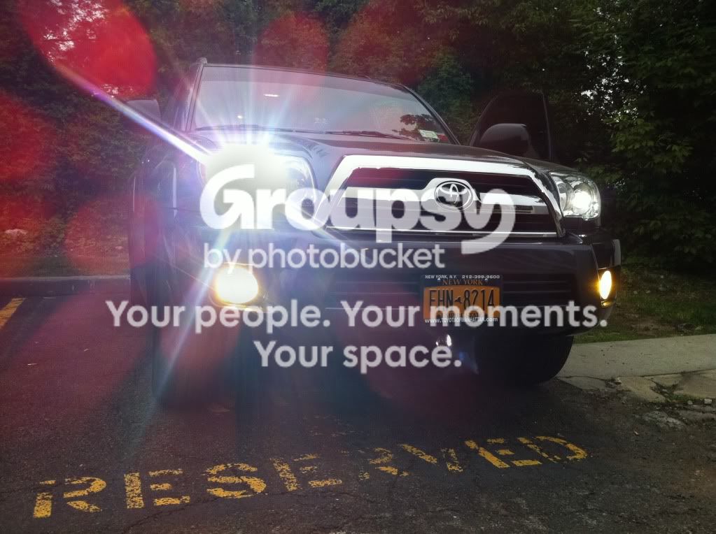

hey all. little project a friend and I did over the weekend. Came out really really nice. figured id share for any interested in seeing the results. Basically took a set of 2008 projector headlights from my buddies 08 runner and installed them in my 05. Installed them with lightwerkz H11 HID kit in 6000K up top and 9006 HID in 6000k for the fogs. Switched the parking lights to LED's and high beams to silverstar ultra's. Also changed out the drl's to clears although now I have 9006 LED bulbs in 6000k on order for them. Also switched out the rest of the trucks lights with all white LED's (Vanity lights, overhead light, rear trunk, glove box, courtesy lights in the doors, running board, reverse lights, and license plate bulbs) In order to complete the headlight swap the only part I needed besides the headlights was the trim for under the lights. That came from Toyota which comes painted for 80 bucks (cool). Few hours later... results :)

Driving the truck at night there is so much more light on the road is ridiculous. opening the doors its a bright as day, maybe a little to bright actually but i don't care. I love how clean the light is and finishes the truck off perfectly. anyhow just wanted to share so hope u enjoyed. Know the pictures don't really show the lights well but, if you are thinking about doing this, do it!
