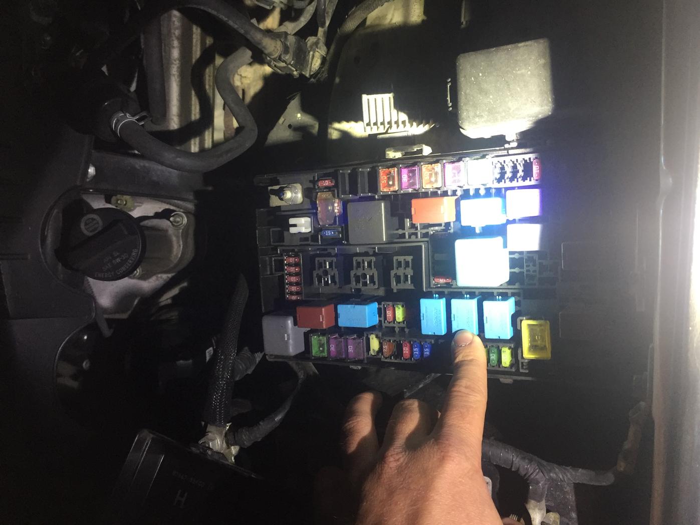

Anyone heard of any similar issues where it turned out to be fuel related ? Its almost like its cranking but not getting any fuel to start. Is there a relay or anything that might be loose or on its way out that controls whether any fuel is sent ?
The blue relay i have my finger on, its the EFI relay, you pull it and it will crank no start.
Cool thanks for the info , Ill check to see if its in solid. Ever heard of that relay going bad causing intermittent issues ?
Relays don't usually fail as often as other electrical components, most of the time if a relay fails it's because of a problem farther down the line. Not saying that they cant randomly fail, but they are easy to test via DMM or good ole swapnostics probably have better luck with swapnostics if it is an internment issue. Also check the engine wiring harnes for any damage, rodents loves runners almost as much as we do. If nothing is found i would pull a Jeremy Clarkson and start with the Technical taps
