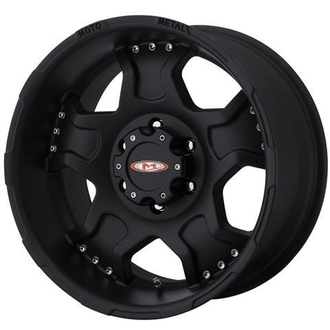

OK I think I have picked a wheel. It is going to be the moto metal 957 in matte black. I need some help on deciding the size. I like the 20" or 18". I think I am partial to the 20's but am worried about tire size with my stock suspinsion. I don't want any rubbing. I am looking at the toyo open countries, nitto terra grappler and dune grappler. Anybody know what is the largest size I can go with no rubbing for 18" and 20"? What if I use the 1"leveling kit on the front, can I go bigger?
