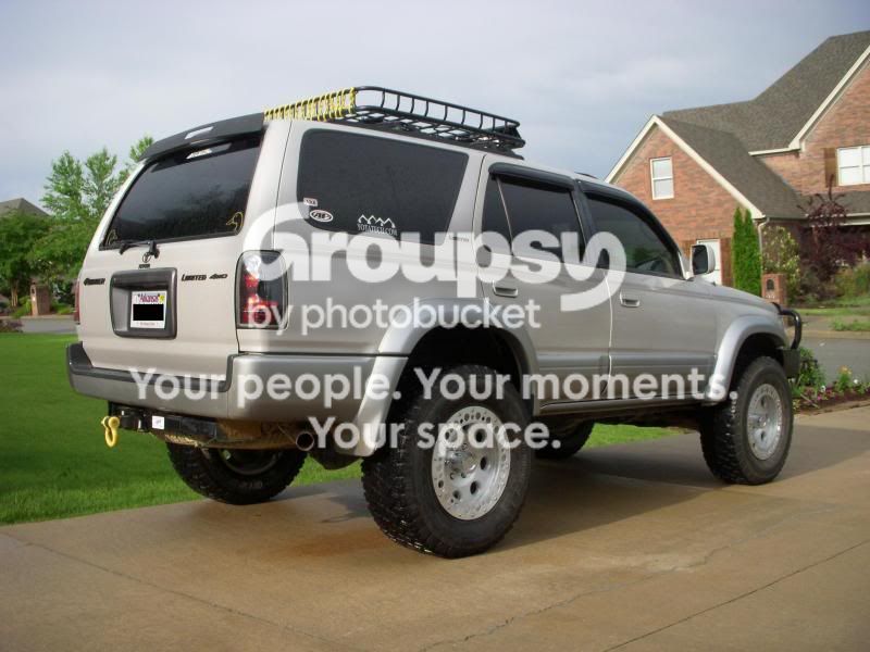

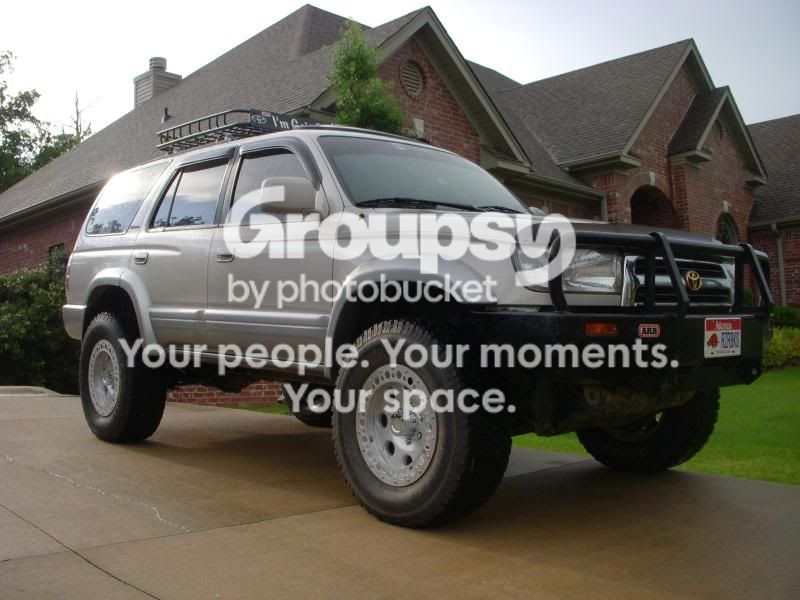

without
DSCN1409.jpg~original
with
bodylift2.jpg~original
although I have different tires and wheels in these pics they are still 33s. Just different rim sizes

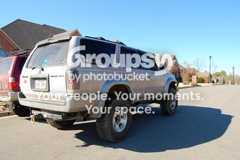

Another without
DSCN1406.jpg~original
With
IMG_0815.jpg~original
Thanks for the pics, i looked at the first one and i was like oh that not much of a difference but then noticed it said without :ybrick: and scrolled down a little and was like oh there we go!!! looks a lot taller, and it looks really good, defiantly what im going to need to do! Oh ya is there a way to get the bumper to line up better with the body or is that just what happens when you do a body lift? Thanks for the help
well, since I have an aftermarket bumper there is no bracket to bring it up. I'l have to mod the brackets on it.... eventually. With yours, 4crawler makes front bumper brackets that you'll want to get. Or else your bumper will have a gap between the body like mine does. The rear bumper is attached to the body so no messing with it.

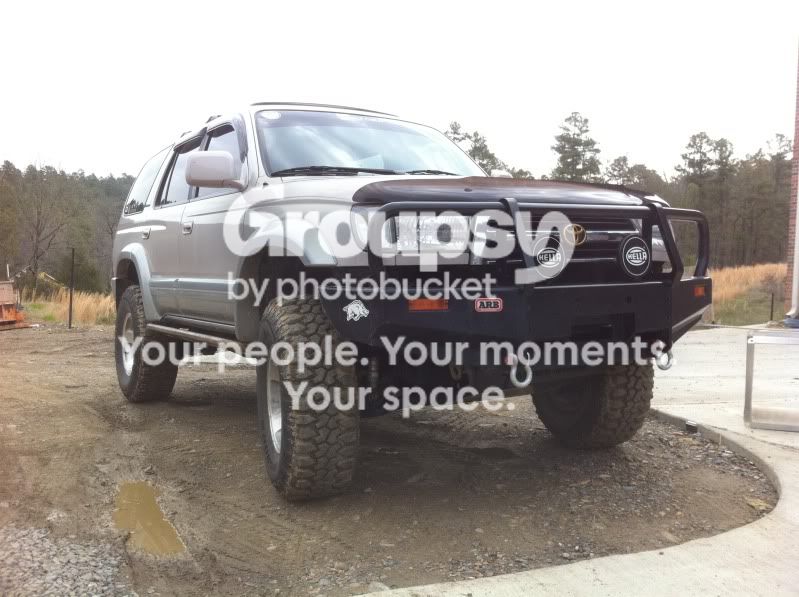

You can either cut the mounts for the ARB bumper, and reweld them higher...
ARBblAdaption.jpg~original

Thanks Brian.. I've searched on it. I think I'm gonna go with the cut and reweld. I'm also going to gusset the brackets to make them stronger for future winching as well as plate the end caps while I've got the bumper off. I've just been putting it off haha. So much to do, so little time!!
I think the cut and weld method is easier, I just didn't have access to a welder at the time, but I did have a drill! If you decide to do the drill method, the bumper won't go straight up. You have to drill your new holes 2" down (or whatever your body lift is) and then 3/16-1/2" towards the back of the bumper - see my pic. This will allow it to come forward a little bit as it comes up so the bottom of the bumper will clear the brackets (weird angle). If what I'm saying isn't making sense, you'll see what I mean if you go to do it.
