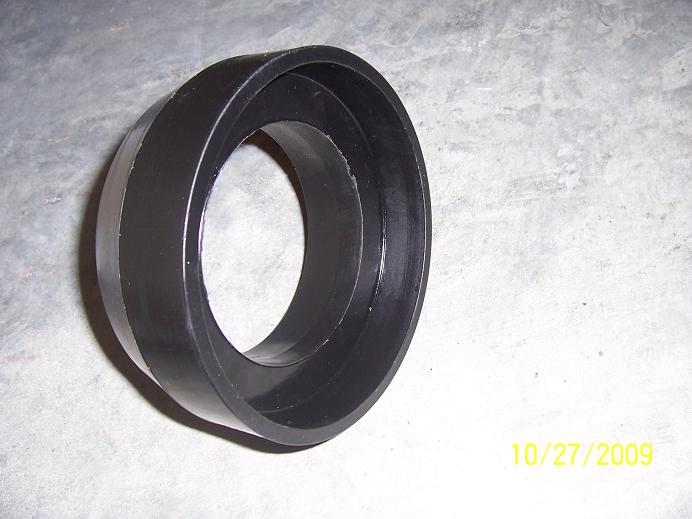

Just want to make sure, is that a spacer you had installed? Or yours looked deferent?
