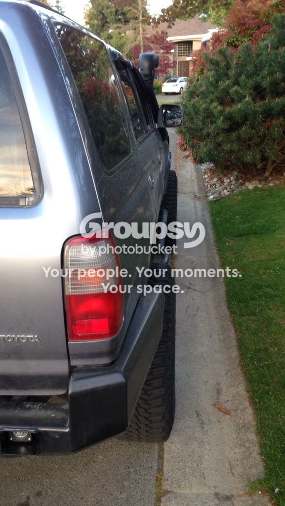

Don't run them with anything wider than stock wheels unless you want lots of poke:
My track width is 5" wider than stock. As mentioned, the width will add a lot of stability but also make the tires rub a lot more. To eliminate the rubbing with 285/75/16's and 2.5" of lift, I had to cut the front fenders and roll the rear ones, as well as all of the inner fender work.

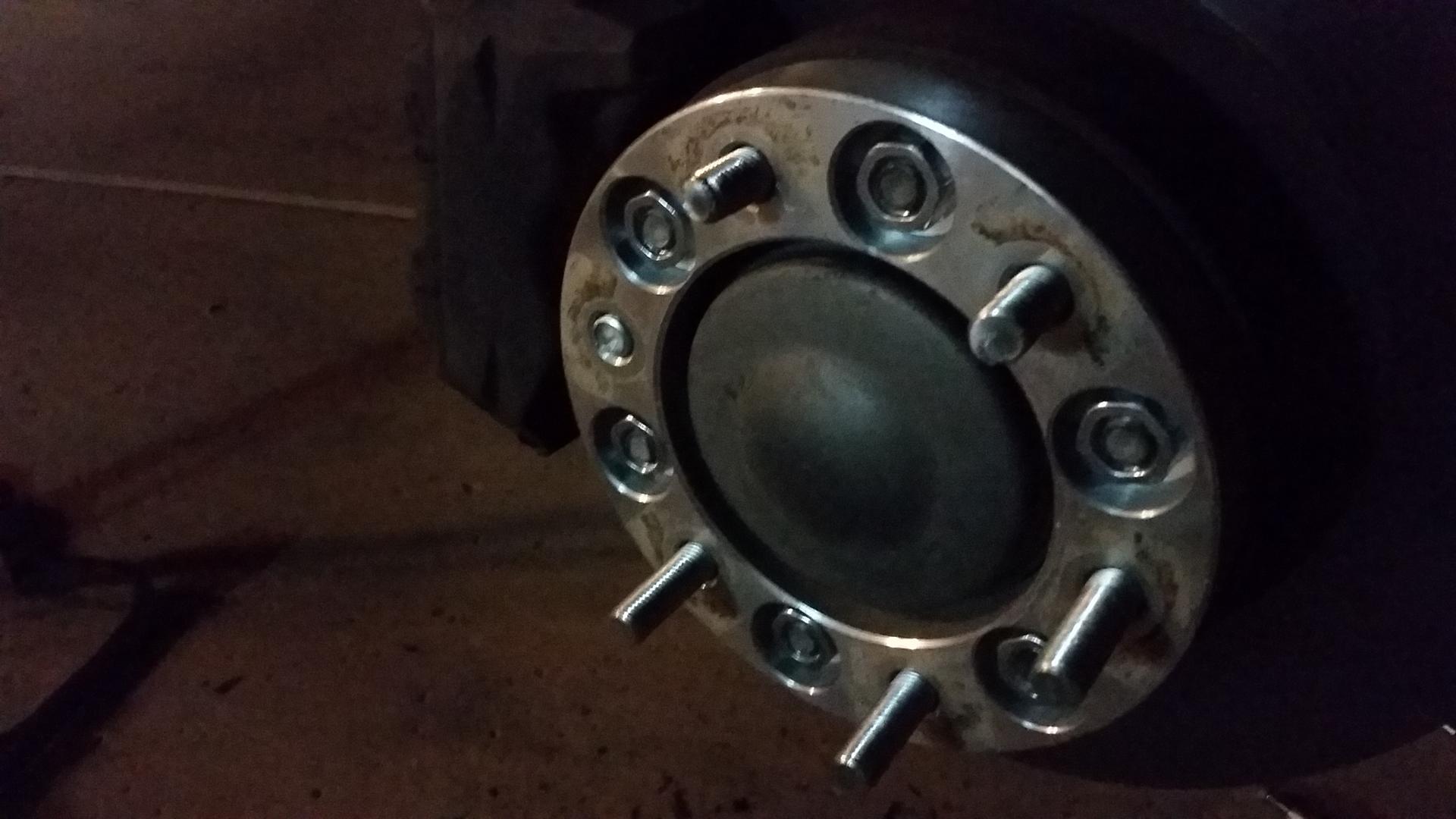

[MENTION=79826]absalom[/MENTION], my comment wasnt to correct you, but rather to clarify that the lug centric wheel spacers dont play well with oem wheels. that being said, ive also had some other issues with the hardware quality on the ebay wheel spacers. you were there when I was backing that lug off, the first 3/4" off threads came out fine and then the lug nut seized up, in order to get the wheel off I had to break the end of the stud off, and all three on the same spacer happened the same way. the thing I like about the spidertrax is they are also anodized and have proper length studs.
