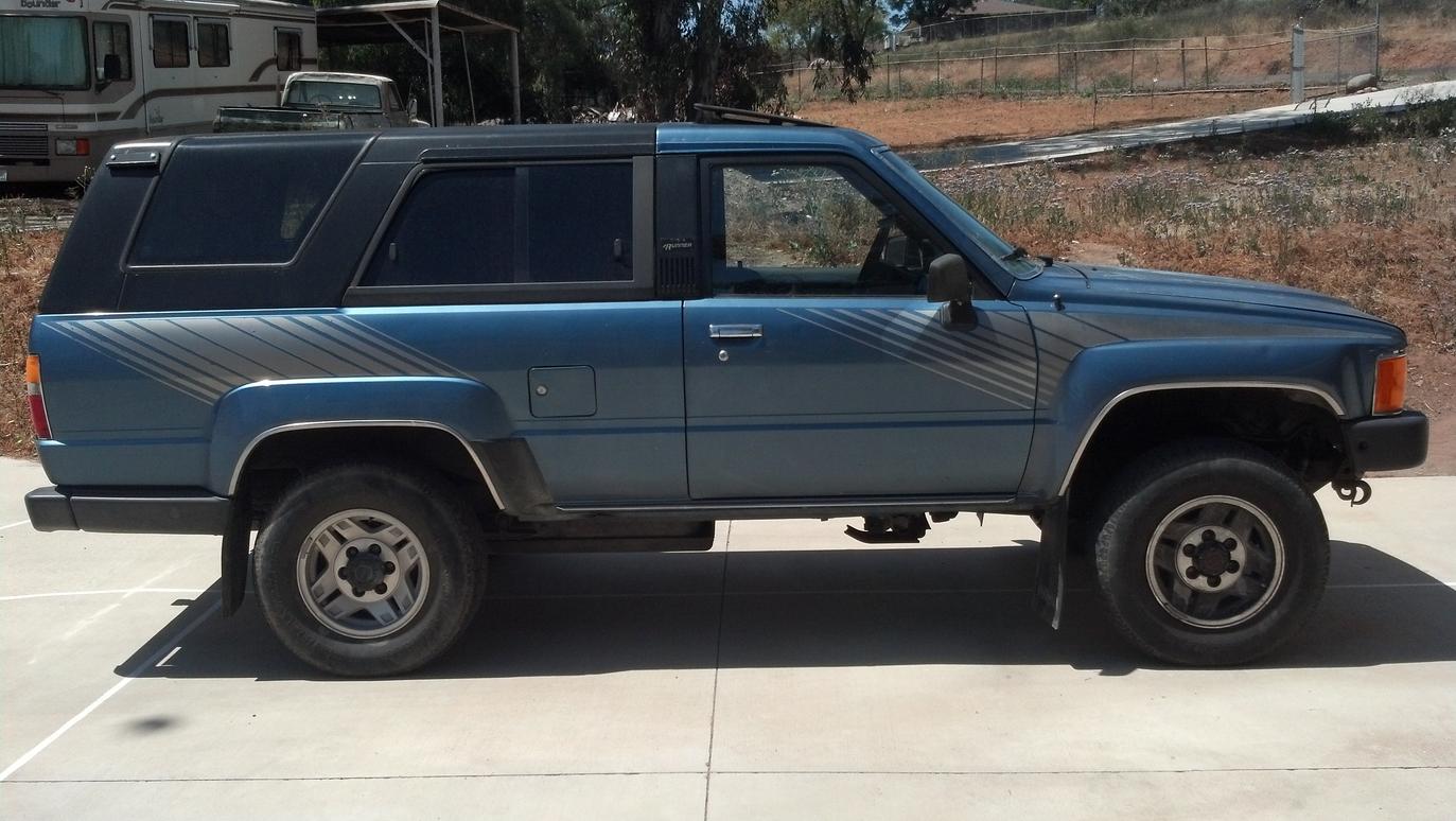

I am looking for rear springs (prefer new) that will correct typical saggy butt and restore factory height. What have others used for V6?
