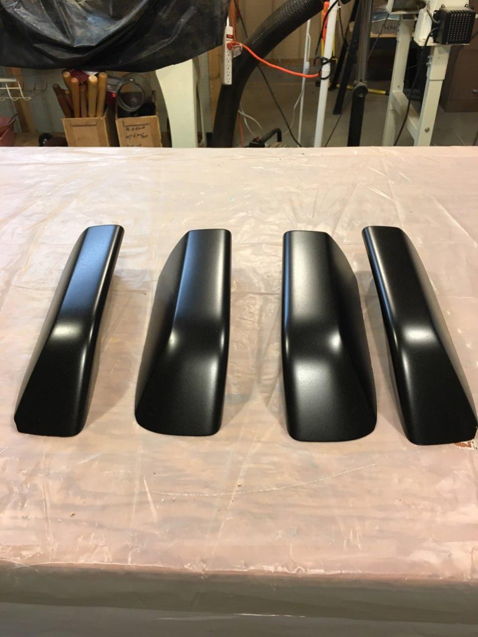

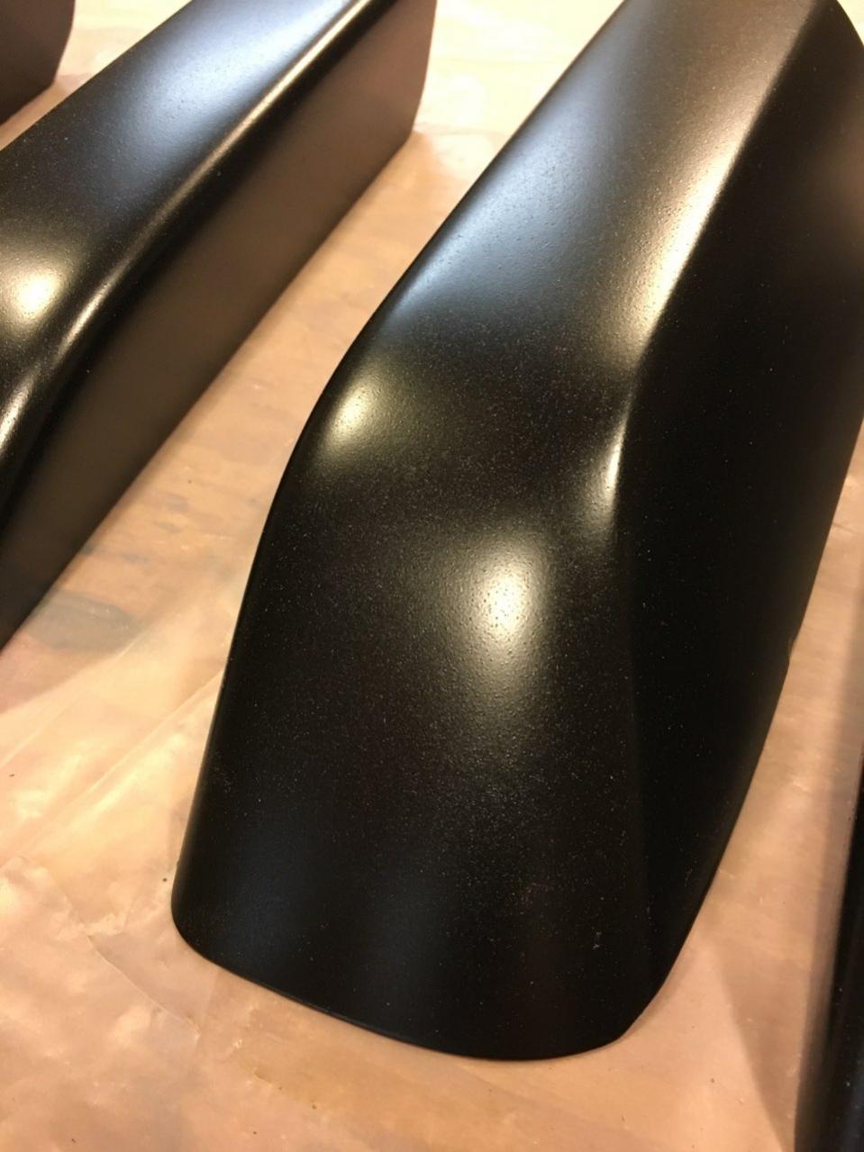

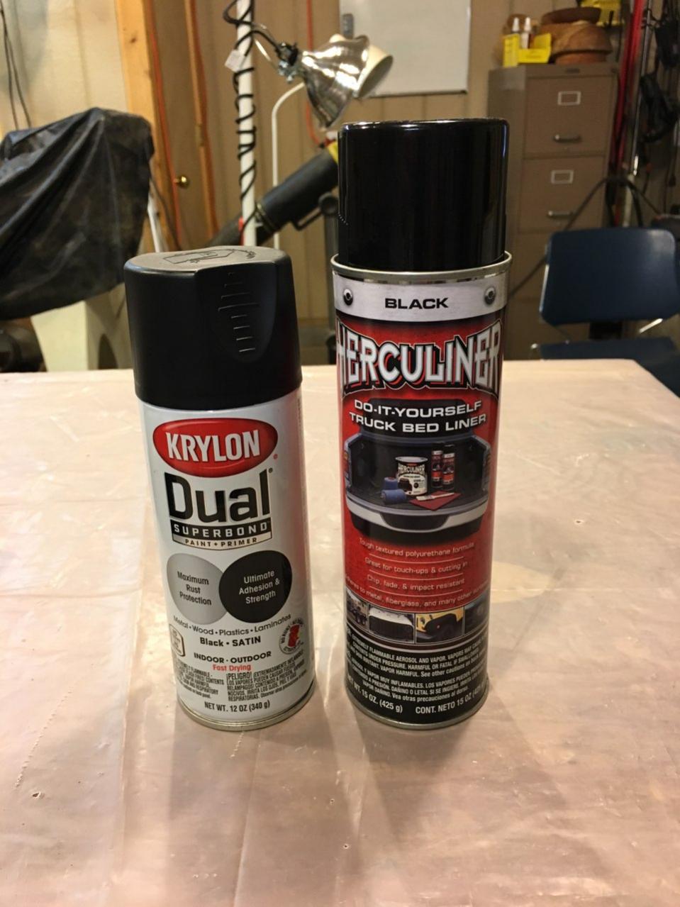

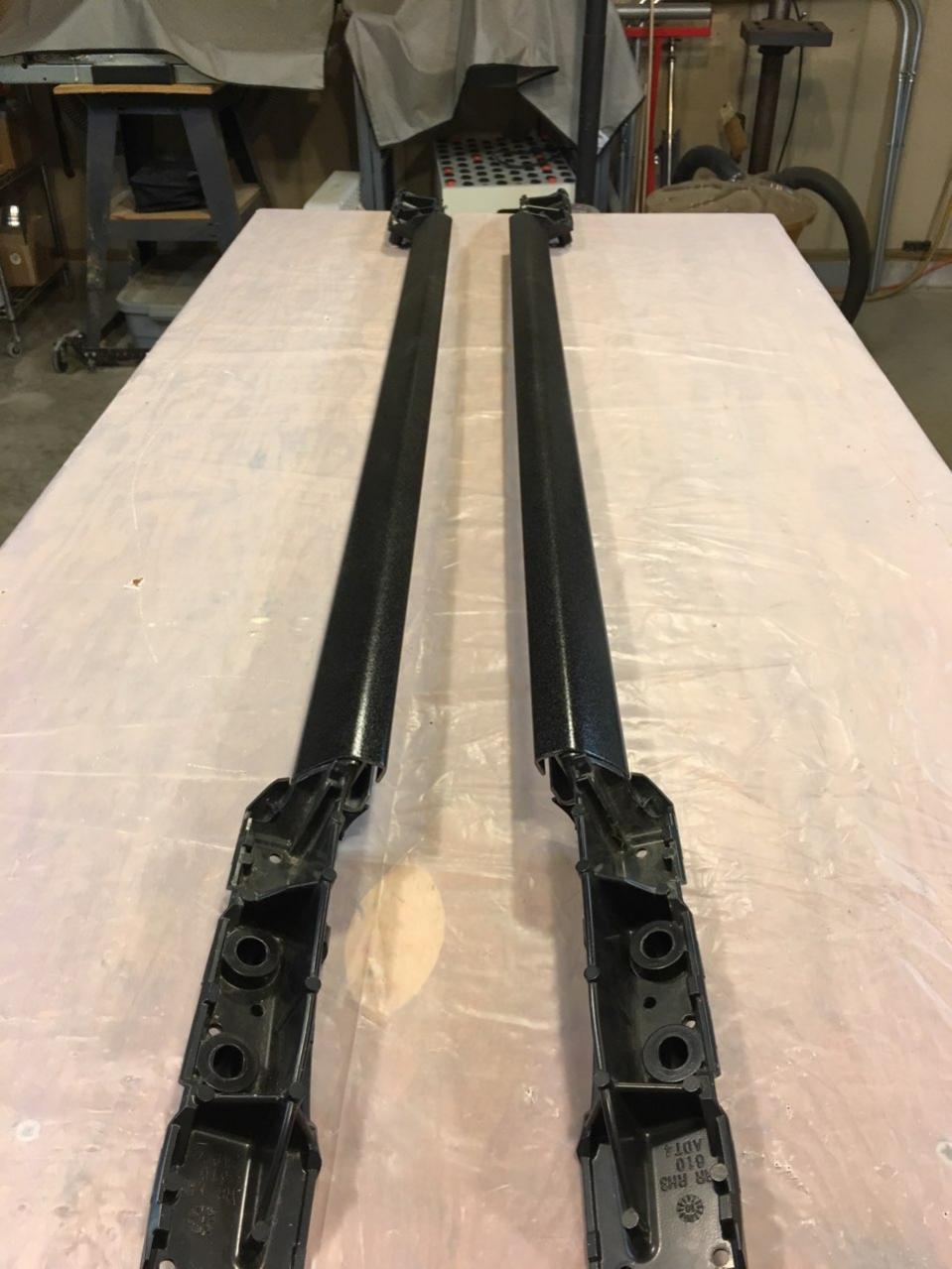

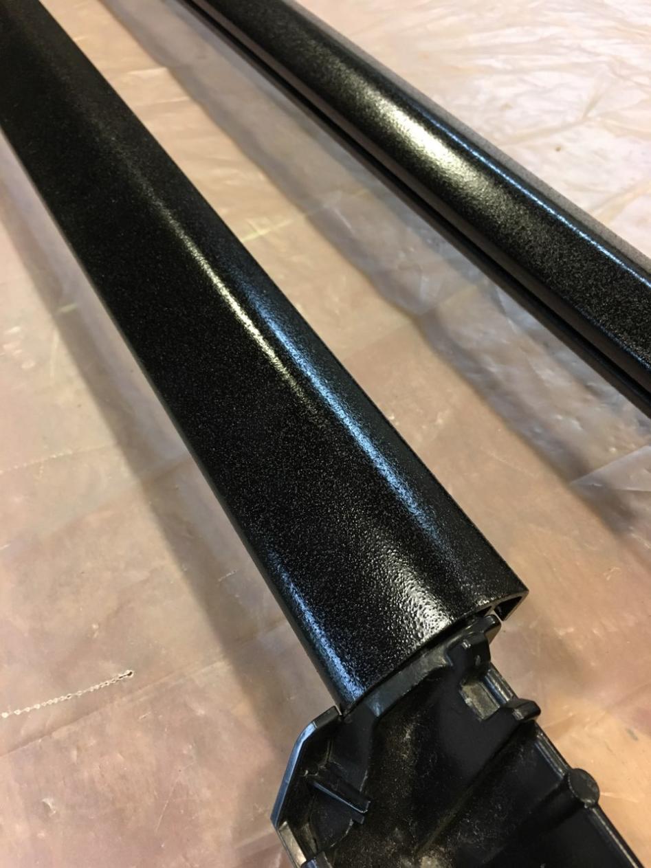

I decided to go back to the OEM rack for now, but I couldn't stand the silver rack that came with the premium package. I completely disassembled the rails and roughed them up with 150 grit, and sanded down the caps with 400 grit just enough to knock the shine off them. I used Hurculiner spray for the rails ($14) and Krylon for the caps ($6). They are a little rougher texture than OEM black rails, but they came out great.
