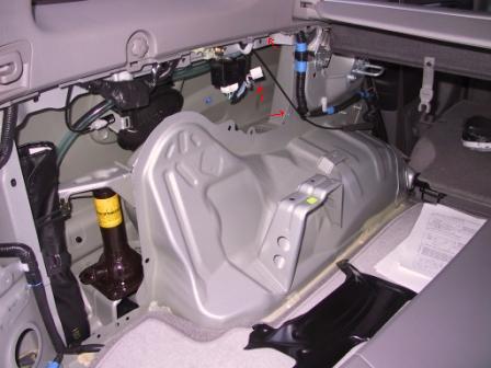

And if you really want to keep the factory look, you can always just wire up your own inverter in the factory location. The red arrows indicate the factory wire connector and the bolt locations.
Besides an inverter, there is plenty of space here for amps, speakers, CarPC, ....

rando... if you could just tell me how you removed the plastic panel to get to all that I would be very greatful!
OK, but it's not a quick procedure and it's probably a little different if you have the double decker or 10 speaker system or 3rd row seats, mine is just the standard 2 row cargo with 6 speakers.
1. Remove your cargo mat.
2. Remove the plastic trim piece that covers the floor, at the back of the truck. It's 4 or 5 screws and then it's snapped on (real tight). I taped the head of a flat screwdriver and used that to pry it up. BE CAREFUL!
3. Remove the bridge between the 2nd row seats and cargo area. IIRC, it's just the two bolts holding down the cargo hooks.
4. Remove anything else that appears to be holding down the floor board. I don't remember if there is anything other than 1-3 above.
4. Slide out the cargo floor board (more carpet really). It comes out and goes back in easily.
5. Remove the upper left cargo net post (it's actually a clip). This is a little tricky at first. The very tip of that piece is actually a thin cap. Pull hard just on the very outer edge and it will pop up and release the clips inside. The whole thing then easily comes out.
6. Remove the cover of the 2nd row left passenger seat belt (where it attaches to the body). It just pops off....REALLY
7. Remove the bolt (the one revealed by removing the cover)holding the 2nd row left passenger seat belt to the body
8. Remove the screws/bolts holding the lower left interior panel in place. There are 2 on the floor, 1 in the box, 1 inside the cargo hook, and maybe a few others I don't recall. Look for them ALL. DON'T try to remove the box or cargo hook, just the screws. YOU CANNOT remove them from the outside.
9. Remove (or partially remove) the 2nd row left passenger door modling. You just need to lift up the part that's adjacent to the interior panel. The panel actually has clips that fit UNDERNEATH the molding. Don't worry, the molding is not glued, though it does feel like it is, at first. DON'T REMOVE the whole thing, just the little bit you need. That way it will be easy to get lined up correctly again.
10. Remove the 2nd row left passenger door sill. It just pops up.
11. OK, now there are about 5 or 6 clips holding the interior piece in place. I started prying them up from the back to the front. Once you get them all, the piece just lifts out.
12. Good luck and don't scream at me if you break something! :D
Also, don't be confused by the carpet in my picture. I just threw that back down AFTER I removed the panel. You CANNOT remove the panel without removing ALL the carpet on the floor.

Can you post a picture of where you mounted your inverter?
sorry but getting a picture of the inverter installed wouldn't be practical because it tucked away in the rear quarter panel. But just look at the picture with the arrows on the first page. That's where its installed (again because it is an oem piece). Everything plugged in with no problems
