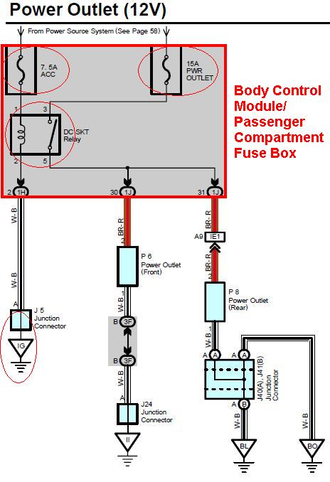

When you say you checked the fuse, which fuses did you check? And how did you check them? Unless they redesigned the circuit, there are actually two fuses for the power outlets. One for the relay coil, which is powered when the truck is on, and the other fuse for the outlet power, which should have power at all times. You may want to double check them. Use a meter on both sides of the fuse contacts. Or if you don't have a meter, simply replace them, regardless if they look good or not. It's not always obvious when they blow. Fuses are cheap.
Otherwise, you can also check the relay. However as new as your truck is, I highly doubt there's a fault with the relay. There could also be a problem with the coil ground, however again, as new as your truck is, I doubt it.
If you have any interest in it, this may be a good time to do the "full time power at the power outlets" mod.
