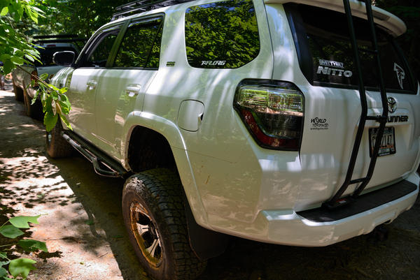

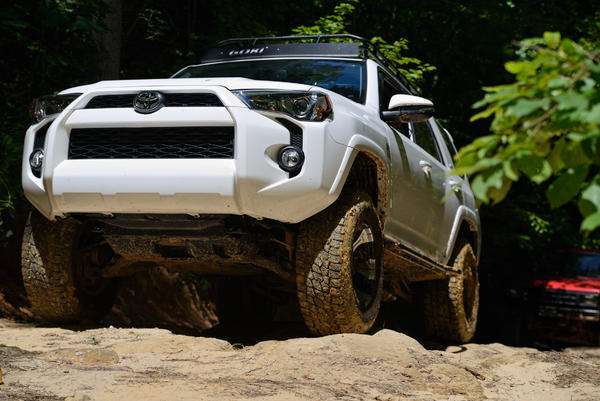

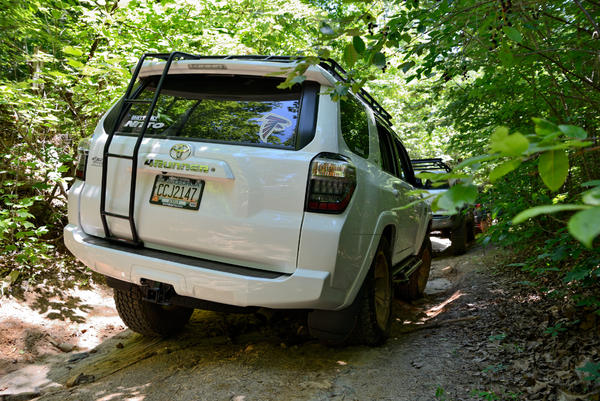

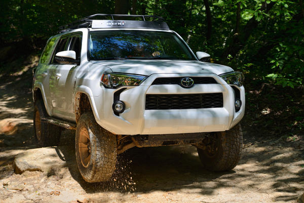

Ok, don't mean to start another debate about this but all threads that I've read and searched for were of people sharing their MPG's and anecdotal stories...... and that included pissing matches :whip2:
I am kind of baffled that Toyota and other shops think this is normal...... I've seen other runners with the same lift/tire combo's not being this bad and still getting at least 17 MPG or the very worse 16.5 or so .... but 14.6?
I got full OME 3" lift and nitto's 285/70/17's, just then it changed to 14.7/14.8 ...... after that I added the GoBI and 4x4 labs sliders and didn't move much after that
What gives?....... I would consider myself a regular driver, not super "led footed" or grandma for that matter.
Looking for real ideas and not flame wars please.
Im in Atlanta, bought it in March, was getting 18 to 19 before. mostly city but hit trails in the GA mountains once or twice a month.
Also, the question about the speedo came to mind and i checked against my Phone's GPS apps (Navigon/TomTom) and is very accurate, stealership (and 4wheel parts) says that if that is correct then there is no need to change anything (even though they don't offer the service to update that anyways).
Help..... if this is it then so be it, didn't buy this for the fuel economy but........ something IMO is wrong here.
Thanks guys, great group of folks here, learned a lot throughout the years so I owe all of you :thumb:

Think about it.
1) you've gone from a 31inch tire to a 33 tire, larger diameter, more weight
2) you've added more weight with skids
3) you've added more wind resistance with a roof rack
What were you expecting?
Also, how are you calculating your mpgs now? You're trucks mpg calculation will be wrong given the larger tires.

Thanks for the feedback man, I lost that just with the lift/tires and before the rest of the upgrades, so skids/gobi had marginal effect on fuel. To go from 18/19 average to 14.6 on just tires seems a bit excessive but Im here to hear from all you guys so if it turns out to be expected like I said so be it.
it take more effort to turn weight than carry weight.... Additionally if you are using your dash MPG computer you are wrong. I would venture to say you might have lost 2mpg (to be expected)
fun science project: Ask your significant other to sit on top of the 4R.... no change. Tell her/him to bear hug a tire and then drive down the road.... change for sure lol
Normal. TBH, most of us don't expect much MPG when we mod the snot out of these things. I get about the same milage you have with all my armor and regear and 34s. Biggest hit was lifting for sure. Changed everything. Also, there are times when I am driving city mostly and I can drop all the way down to 12 MPG. It is the price of admission. You have a beast of a trail rig. There are reasons Toyota didn't sell them with the 33s and lifted... CARB...
So you're changing your tire diameter by 3.5% by moving to bigger tires. So you should calculate mpg accordingly. Miles via trip computer per tank multiplied by 1.035. Then divide that by gallons consumed according to the gas pump.
That will be your most accurate mpg.
Bigger tires also mean more weight, therefore more power required by the engine to get the thing going. More power = more fuel = less gas mileage.
At least 90% the tires. I have roof rack, sliders and 3/2 lift and still get 18.5 to 19 on my daily driving on stock sized AT tires.
As said above use (miles / gallons at pump) * 1.035 to find real milage.
If I decide to go 33 on my rig im going to regear to get the engine load and gear ratios back to normal. The milage should then only drop a little. You're fighting a lying odometer and a stiffer gear ratio (engine rpm to wheel rpm) to get your vehicle moving.
So you're changing your tire diameter by 3.5% by moving to bigger tires. So you should calculate mpg accordingly. Miles via trip computer per tank multiplied by 1.035. Then divide that my gallons consumed according to the gas pump.
Bigger tires also me more weight, therefore more power required by the engine to get the thing going. More power = more fuel = less gas mileage.
This is exactly your issue.
