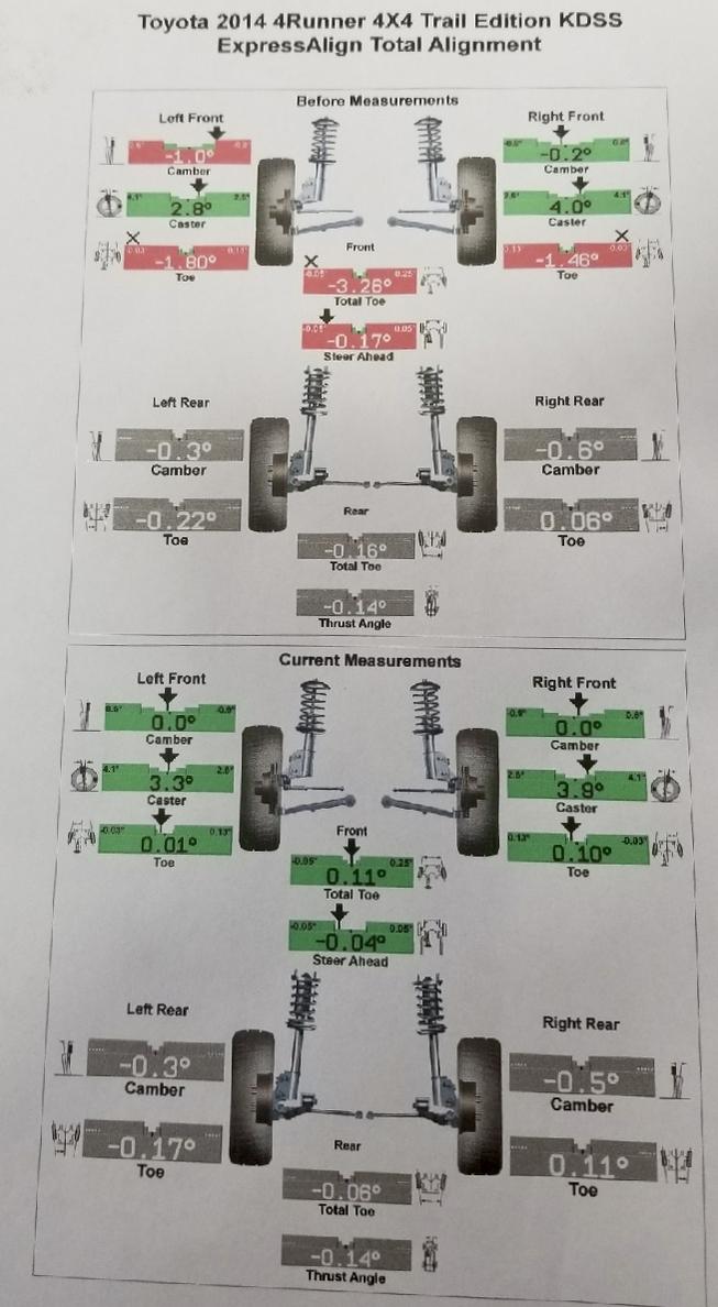

Hi Folks,
Happy belated Thanksgiving. I hope everyone had a great time. I recently have put my 14 TE w/KDSS through the beginning stages of evolutionary phases of modifications (2 down 3 to go).
I started with "Shoes". Suspensions, wheels, tires. I elected to go with ARB/OME; Heavy Springs up front & Med in the rear (In preparation for the "bull bar (ARB) and winch).
Before the Front bumper was installed the "Lean was completely gone. I knew this was temporary as much of my research led me to believe that once the "Anchor" (Bull bar and Winch) was added that it will return ("Lean"). I've been thinking of adding a small "spacer" to the right front (passenger side) to get rid of the lean. Not sure if that's the correct course of action.
The "Lean" never bothered me before, until I rode for a couple of weeks without out it....and for whatever reason (it's nothing to do with performance or ride) it does.
Here' are the alignment numbers before the "anchor" and no UCA's and after. Suggestions are welcome.
BTW it rides amazingly now! (Love it!!)
have you tried the KDSS calibration? that often doesn't solve the problem permanently, but it's a good first step.
