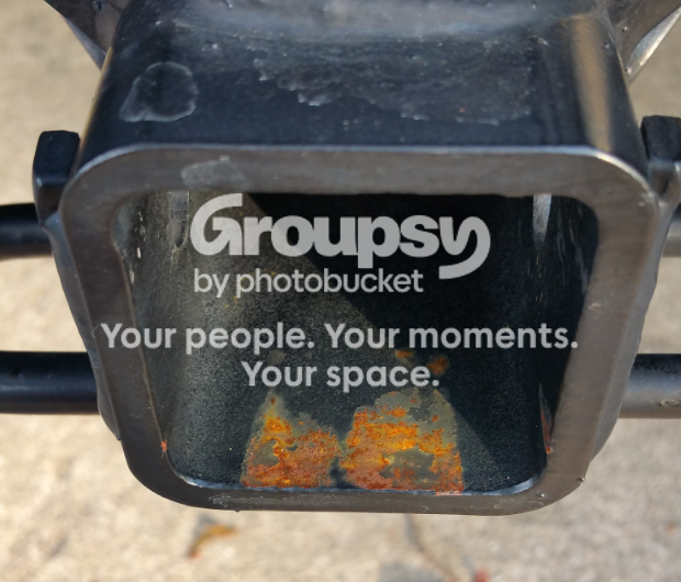

Plastidip: I agree with not using plastidip (IMO on anything), but especially on this.
Rust Converter: I tried Ospho first and it was largely ineffective.
After Ospho
Paint: So then I used RustBullet Automotive 2 coats grey, the 2 coats gloss black, after sanding and de-greasing the area first.

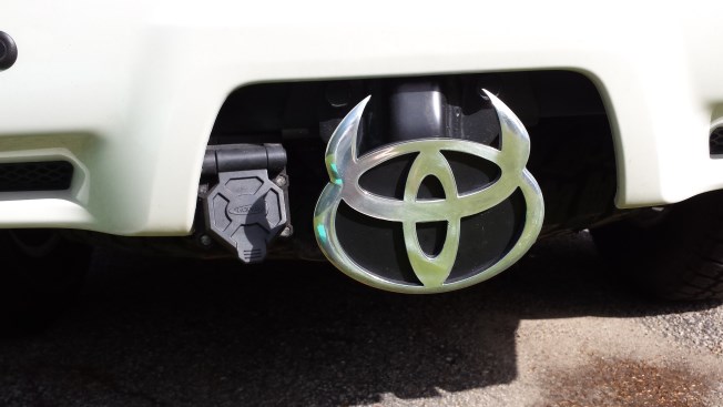

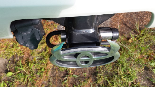

When we're not towing, this is inserted.............rust, what rust?

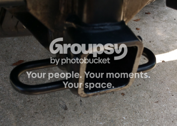

Just wondering if anyone has had hitch rust and what paint you have used to fix it.
Just finished treating the rust on my hitch receiver last weekend - a quick wire brushing, then a coat of Beauti-Tone Rust Coat (from Home Hardware up here in Canada). Now its nice and shiny for the summer.
