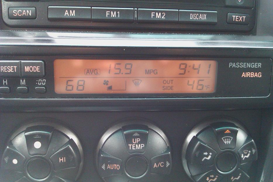

I got 06 SE V6 4WD last week with 60,000 miles and computer shows am getting 15.9 MPG. It is still stock and has stock size BFG long trail tires. I think mpg is too less, what you guys think?
I used to have 05 V6 2WD and I was averaging 18.5 mpg. I know I can cannot expect the same from 4WD, but I think it can (should) improve.
What you guys recommend?

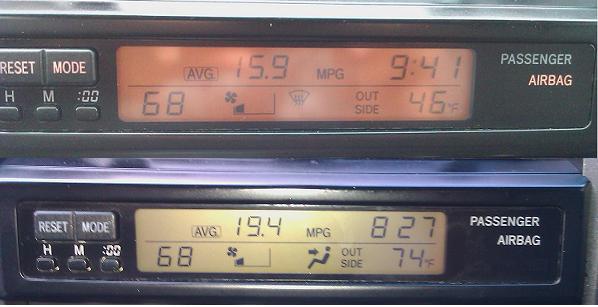

Did seafoam my 4R today. Only did vaccum line and gas tank. Also went ahead and cleaned out the MAF as well. It shows I gained about 3.5 mpg with this treatment. I have not hand calculated it yet, but usually compauter is about 1 to 1.5mph too optomistic. Even then its an increase of 2 to 2.5mpg.:thumb3:
